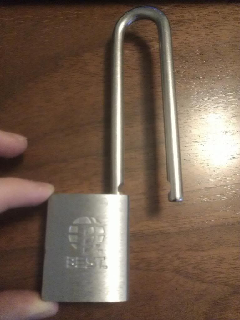

I picked up a Best IC padlock for cheap about a year ago, and although the lock works fine, the rest of the padlock is broken. The shackle is jammed open and doesn't swing any more. It jiggles, but it won't move significantly in any direction and I can't see anything that might be blocking the motion. I'd like to be able to fix this so the padlock works again. Has anyone ever run into this problem before? I can post pictures if it would help.

Postby averagejoe » 6 Jan 2014 17:33
My thread only applies to the older models.
If it is the newer ball bearing locking system then the process is different. Some pictures may help us diagnose your problem and help with a solution.

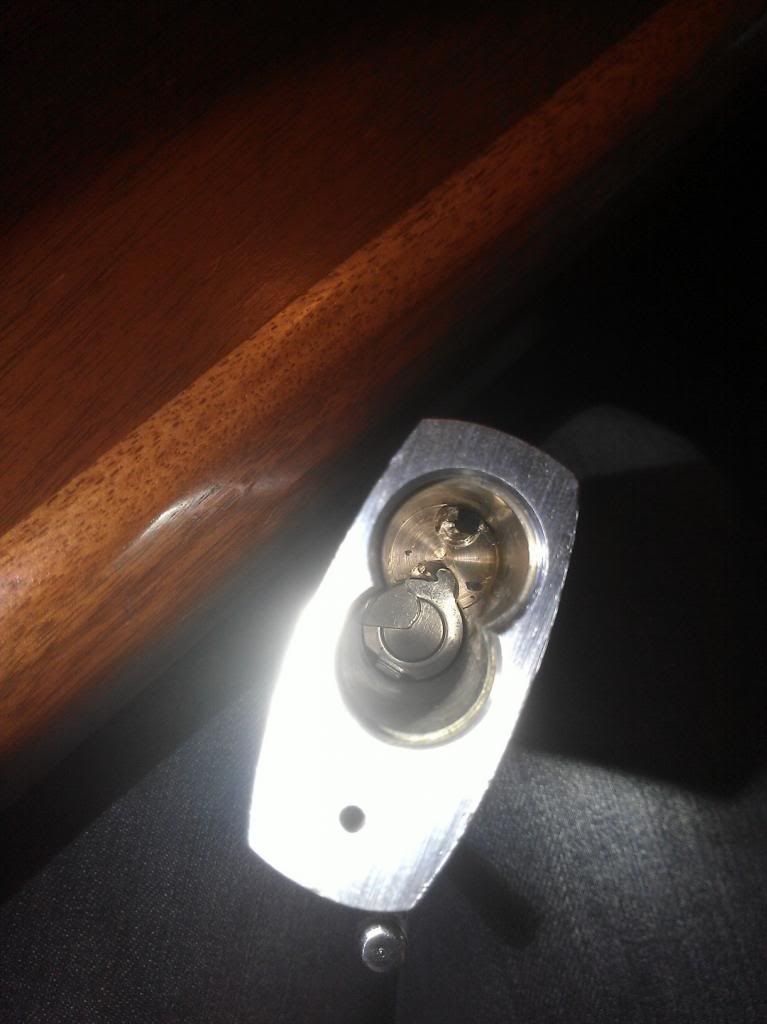

Postby xylac » 7 Jan 2014 16:29
Here you go:
I wasn't able to get a good picture of the top, but it looks like it's a ball bearing style, and that the ball bearing is completely retracted.

Postby averagejoe » 8 Jan 2014 20:37
Yup, that is a ball bearing lock. To get them apart you really need a special too to make it easy.
It looks like the shackle of yours is pushed in. On the side that is in the lock the cutout is quite low towards the lock. Is there any chance you could try pulling it really hard or even hold the shackle and hit down on the lock body with a mallet?

Postby Raymond » 8 Jan 2014 21:06
These new Best padlocks look a lot like an American padlock. Try holding down on the shackle and try to pull or bounce out the center activating part of the lock. Some needle nose pliars may also be able to get ahold of the tab above the spring and thereby pull it out.
The more you pull out on the shackle or hit the lock body with a hammer, the more you will jam it.
