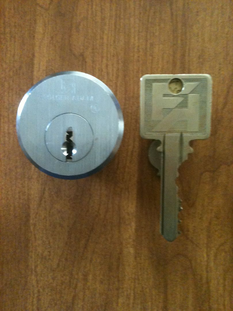

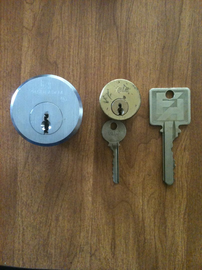

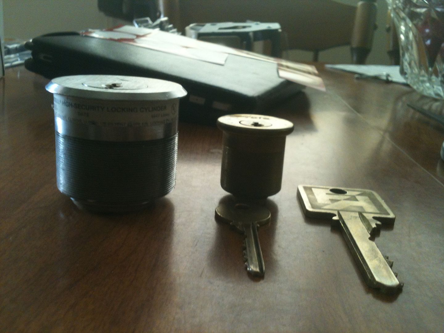

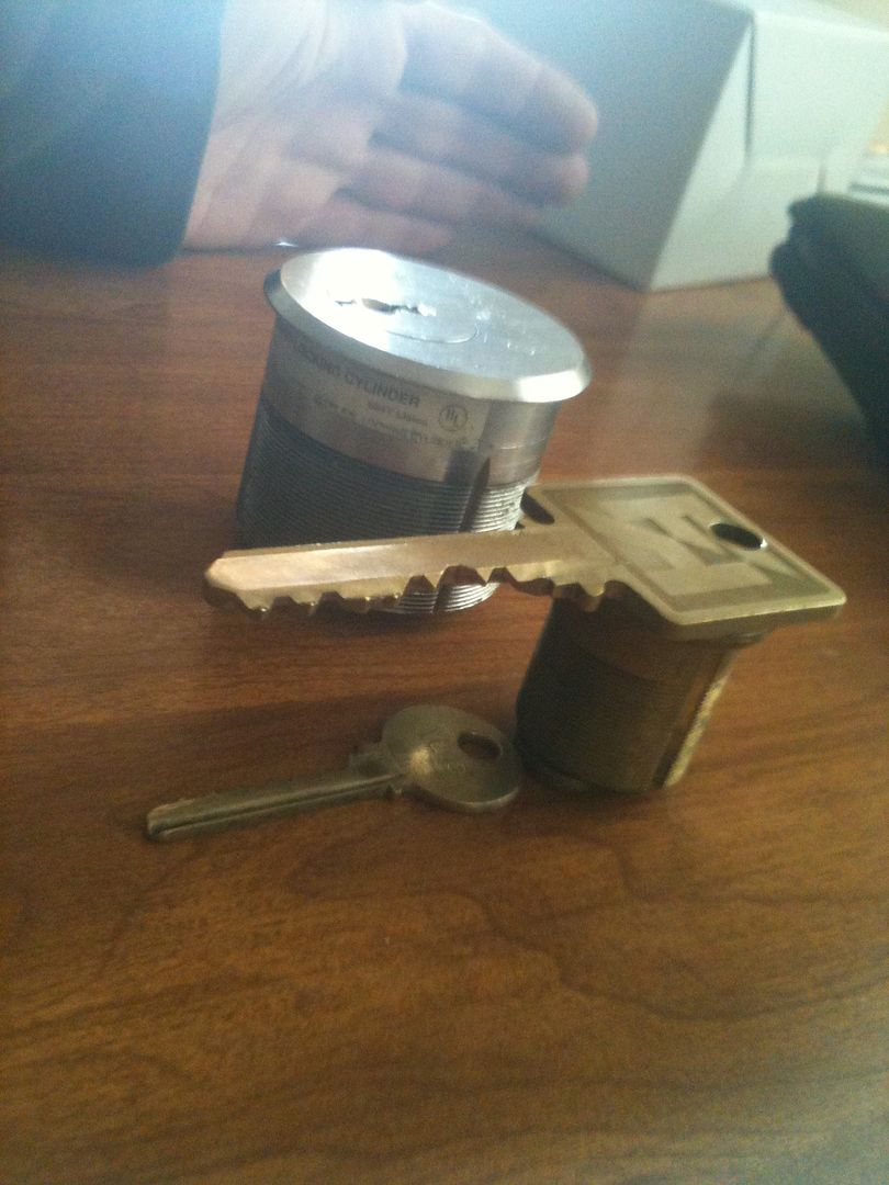

Postby GWiens2001 » 2 Mar 2014 14:31
Loved MacGyver101's writeup. Been trying to get one of those lever-lock beauties for a while now.
Here is a look at the pin tumbler version of the Folger Adam lock. (This would screw into the lock body.)
In the above picture, there is the FA lock, key, and a Yale 7 pin mortise lock and key, just for scale.
Here is the same picture as above, but from a different angle.
This pin tumbler FA is quite a bit smaller than the lever lock version FA in the OP's post. But it is still massive.
Posts: 7661

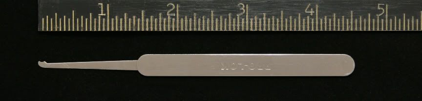

Postby MBI » 3 Mar 2014 17:40
Just cup the balls. Gently, of course.
Sometimes the ball bearings are used to reduce wear on locks that get lots of use. Often just in the first pin stack or two. If you file a groove in the tip of a hook, half diamond (or whatever your favorite SPP pick is) it can help keep it centered on the ball.

Postby spandexwarrior » 3 Mar 2014 17:54
I did that with one of the Southord Max picks. The steel and the .031 thickness made it pretty good for staying on the ball bearings and having the strength to lever up the binding stack.
-Brian

Postby ARF-GEF » 4 Mar 2014 11:58
D'oh I should have thought of that! :D
Thanks MBI :)
