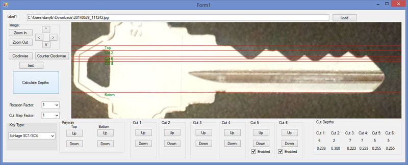

With the resolution of camera's now, it would be possible to determine the depths of each cut for a key..
it should be pretty trivial to write an application for a phone (eg Android) to get the cut depths. it wouldn't be used by anyone who has the proper tools already (locksmith), so it's use as a stand alone app is limited.
when they've done it tie it into a business which can cut the key for you and mail it.. the challenge they will have is the costs or and "errors" or keys which are just a little off, and need to be redone etc.. the cost of shipping will be more then the blank is worth..

Postby ckc123 » 26 May 2014 11:55
After about 30 mins of hacking around.. I have everything but the calculations to determine the cut depths (should take another 30 mins to do that)
and no.. it's not a key that is in use ;)
if anyone is interested in the program/source let me know ;)

Re: A sort-of new threat
Postby ckc123 » 26 May 2014 13:02
Updated now with depth and cut calculations for a Schlage SC1/4. will add kwikset later tonight ;)

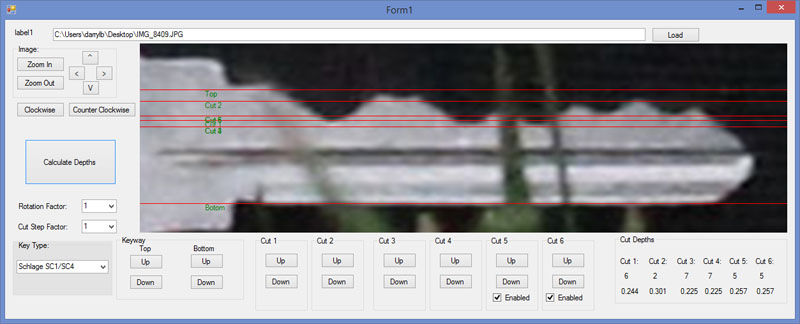

Postby MacGyver101 » 26 May 2014 14:46
Some of the folks at UC San Diego were looking at something like this a few years ago, with similarly "good" results. In their case, they were using a good DSLR mounted on a telescope and reading keys at significant distances.

Postby ckc123 » 26 May 2014 15:47
MacGyver101 wrote: In their case, they were using a good DSLR mounted on a telescope and reading keys at significant distances.
Here is the same key at 25 meters with a zoom lens on my Cannon DSLR.
