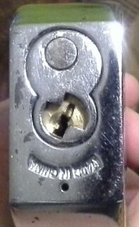

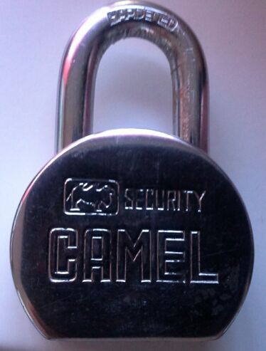

How about a picture or two? Would like to see the front of the lock and the keyway. :D Might even make you a trade offer it is looks cool, even if it is cheap as heck. 8)

Postby Kheops » 23 Jun 2014 13:12

It looks like a IC padlock... but I am not really sure.
I tried TOP tension and in all honesty, much worse. I've never encountered a lock that behaves the way this one does... I wouldn't exclude the possibility that it's got jammed springs or top pins.
