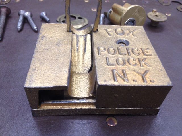

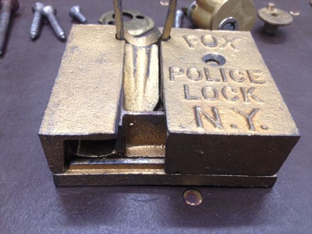

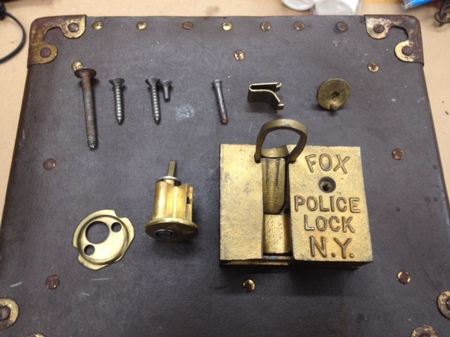

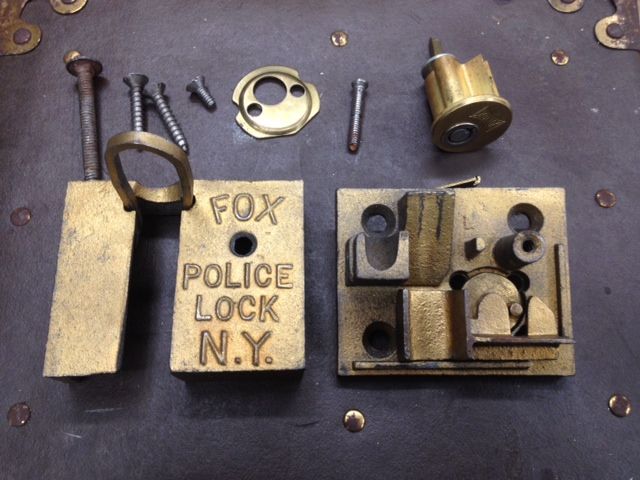

Well, I went back to the flea market today and the vendor that said he had a "prison" lock for me came through, kind of.
It's not quite a prison lock. But it is pretty cool. I couldn't find a tonne of information about it, but it is a Fox Police Lock. Made and used almost exclusively in NYC, the lock is designed to go in the center of a wooden door and holds the end of steel rod. The other end of the rod fits into a notch in the floor barricading the door very securely. When you turn the key from the outside, it slides the rod over in the track allowing it to ride out of the lock as you open the door.
This lock came with a Dyna Lok 7 pin tubular cylinder. I couldn't find much info on this cylinder either.
Locked position. The square tailpiece fits into the round cam on the right hand side of the bolt. The bracing rod rests in the notch on the left side of the bolt and in this locked position it cannot move up because it is blocked by the large piece of metal on the top left.
Unlocked position. The cam slides the bolt to the right aligning the bracing rod notch with the ramp in the middle allowing the rod to slide up and out of the lock as the door is moved inward.
Locked:
Unlocked:

Postby averagejoe » 31 Jul 2014 3:14
Ok, that is pretty cool. I have seen those on ebay from time to time and could not figure out how they were used.

Postby somenewguy » 31 Jul 2014 21:19
I had one of these, I believe it was not installed in the center of the door, but towards one edge like most deadbolts. There's a socket that gets installed in the floor to hold the other end of that rod. You never see them with the rod or floor socket...
