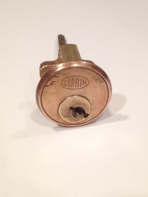

An older Corbin cylinder with ball bearings has been on my must-pick list for months, but my attempts on either of the two I own have all been for nought. To clean one up and get a look at what I was dealing with, I shimmed one and degreased it - one standard driver, four spool drivers; three key pins with ball bearings underneath, two standard key pins.
Even after cleaning and re-assembling, still can't seem to get any feedback, and can pick until my hand cramps with only one or two pins setting. Feather-light tension seems too light (nothing sets), but any heavier and pins bind to the point I can't raise them.
Anyone successfully and consistently SPP one of these that can offer some guidance on technique?
Photo of the lock (and yes, I did realize the key and driver pins in the first position were switched before reassembly :))

I am going to make the assumption that you have picked spool pins before...
Tension is always a tricky part of lock picking .. This should pick just like any other cylinder will spool pins .. I would put what you consider Heavy tension on the core and then slowly in very small amounts back off the tension until you can get a pin to move...

In addition to mseifert's advice, suggest part of your problem may be that the pick is sliding off the bearings. If using a hook, consider using a round file to make a 'pocket' in the tip of the pick to help it stay centered on the bearings.

GWiens2001 wrote:In addition to mseifert's advice, suggest part of your problem may be that the pick is sliding off the bearings. If using a hook, consider using a round file to make a 'pocket' in the tip of the pick to help it stay centered on the bearings.
Good luck, and keep us informed. :)
Good call, that may well be what's happening here. Wasn't giving a lot of thought to the fact that the ball bearings would spin in place...which is a definite oversight, since that's what bearings are designed to do. I've been using both a short hook and a half diamond; since each comes to a point, each would easily be deflected by a rotating bearing. That would explain the weird feedback - the pick being deflected upward may feel like movement of the pin itself.
I'll set the Corbin aside for now and take a shot at making a concave-tipped short hook once I unpack my grinder. Thanks for the suggestion!

Picked one of the two ball bearing Corbins I have. Two bearing, zero spool, not the one in the original post; still have that three bearing, four spool one from the original post to go.
