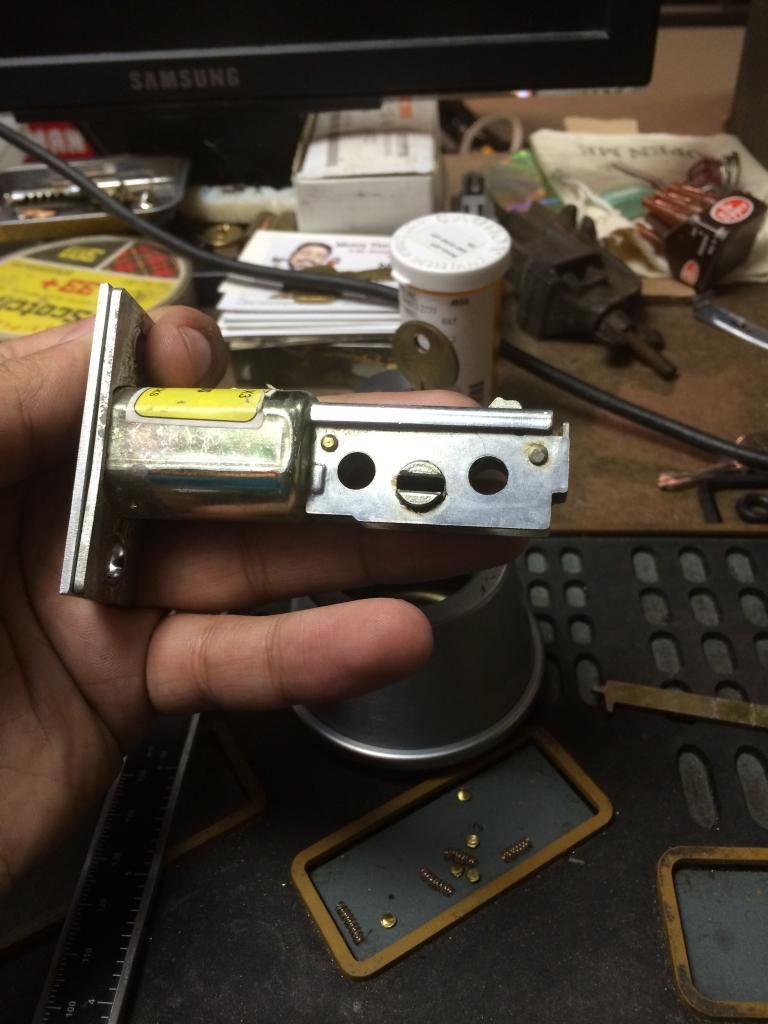

A while back I got this deadbolt from ebay. The cylinder was damaged, so I ordered what I thought was the proper replacement from Best.
Fast forward to last week when the cylinder arrived:
The cylinder is for the Best 8T3 series deadbolts, apparently my deadbolt is something entirely different and needs a smaller cylinder. The latch is Best so I just assumed the whole thing was made by them.
Can anyone help?
Thanks,
Jeff

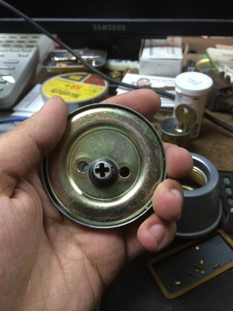

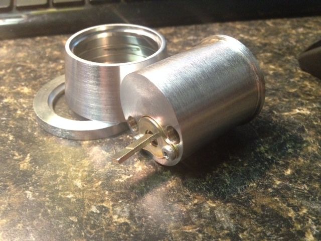

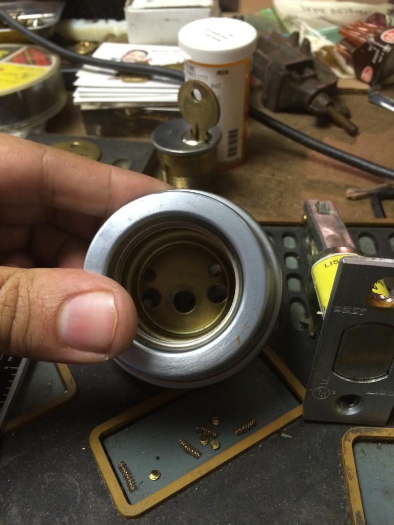

Postby jeffmoss26 » 12 Sep 2014 7:10
I never said I needed a smaller core I need a smaller housing that goes into the deadbolt.
The housing was definitely for an SFIC core. I wish I hadn't thrown the damaged one away. I didn't think Corbin Russwin made any SFIC products, plus the latch is marked Best.
I referred to the part I need as a cylinder because that is what the Best catalog/parts manual calls it: "A23959 outside cylinder"

You are a wee bit confused as some terminology is cross used with other locks. He did not say he needed a smaller core, he said cylinder.
While a rim or mortise cylinder normally refers to the entire lock(plug, pins etc), a SFIC mortise/deadbolt cylinder is a separate unit because the core is not in the cylinder (sometimes referred to as housing). In IC locks the core is NOT a cylinder. I believe this is what is causing you confusion.
If you look in the original post you can see how the cylinder/housing is sticking out the front of the outer collar. If you look in the other pictures a few posts up you can see the lip on the inner collar. This is preventing his cylinder/housing from going into the outer collar so he needs a different or smaller cylinder/housing.
Did that explain things a bit better?
