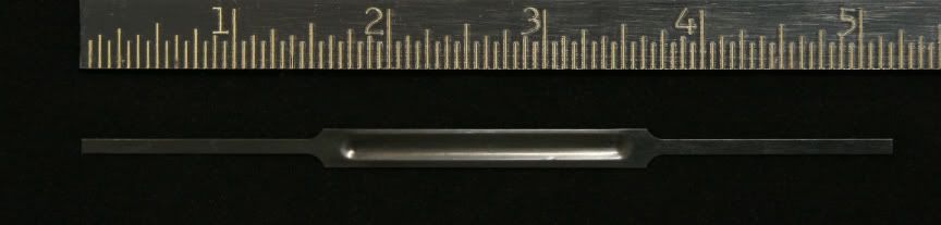

These lock kill devices can be defeated with a Weiser shim, or similar piece of metal, along with a broken key extractor.
Shim holds up the pins while the extractor removes it.
You just need to cut a slope on the end of the shim so when you insert it, it will lift the pins as it reaches them.
They're fairly thin at .008" so there is room in most keyways to insert it alongside the key.
