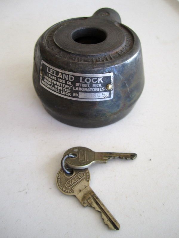

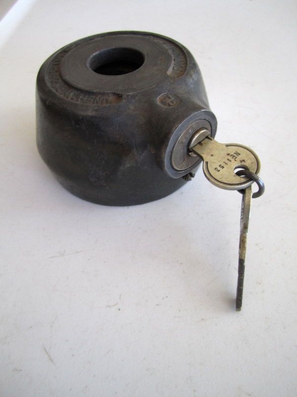

Cool, glad I could help. Here are three other pics with keys I found on ebay:

After closer inspection of the cylinder I noticed some stamping and bit the bullet and hit it with some steel wool (hated removing the patina) and it's stamped 'Sargent' so we have a maker now. It is also stamped 'L2' on the left side of keyway and '44' on the right. Inspecting the keyway it is chock full of crud so it's going to need some work to even fit a key into it. The model you posted is I believe a second generation Leland which is newer than my particular lock. The last patent date on mine is 5-20-19. Proceeding to dis-assemble and pick the lock.

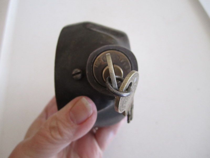

The promised pics but first a follow up after dis-assembly there seemed to be no retaining clips so I'm assuming the cylinder is threaded like a mortise cylinder or pressure fit. Unfortunately the housing is too damaged to attempt extraction.Picking was easy (CCW) once I flushed the keyway and loosened the 4 pins. Impressioning seems to be my on;y option as although I could remove the tailpiece there is insufficient room to use a follower.
+Image
That just about covers what I have for now. hopefully I can find a suitable blank and get an impression soon. Any more info is greatly appreciated and thanks for looking.

I would try an impression first. But with the amount of crud in there you may want to disassemble. If you are able to remove the tail piece to the inside, it might be a cleaner over all job to disassemble, make a key with the plug outside the body, and then use the plug as a follower from the front. It will be a pain setting all the drivers and springs, but there are only four. And you would be able to completely clean everything inside and make sure the key is perfect.

You could use a sectional follower, you would prolly need to make your own, my guess would be .395 diameter, you cut small pieces from a .395 diameter bolt, maybe 1/4 inch each and slowly push them in the backside, until the cylinder has been pushed out far enough to make the key. I have found old pin tumbler locks have sometimes been soo used that the marks are very hard to see, while impressioning.
