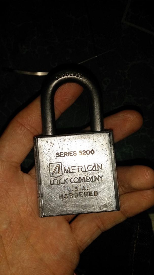

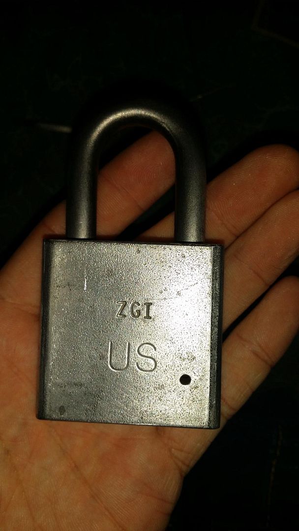

Postby Comrade627 » 26 Feb 2015 23:02

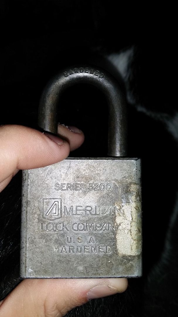

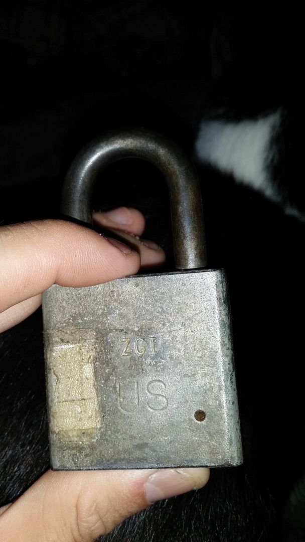

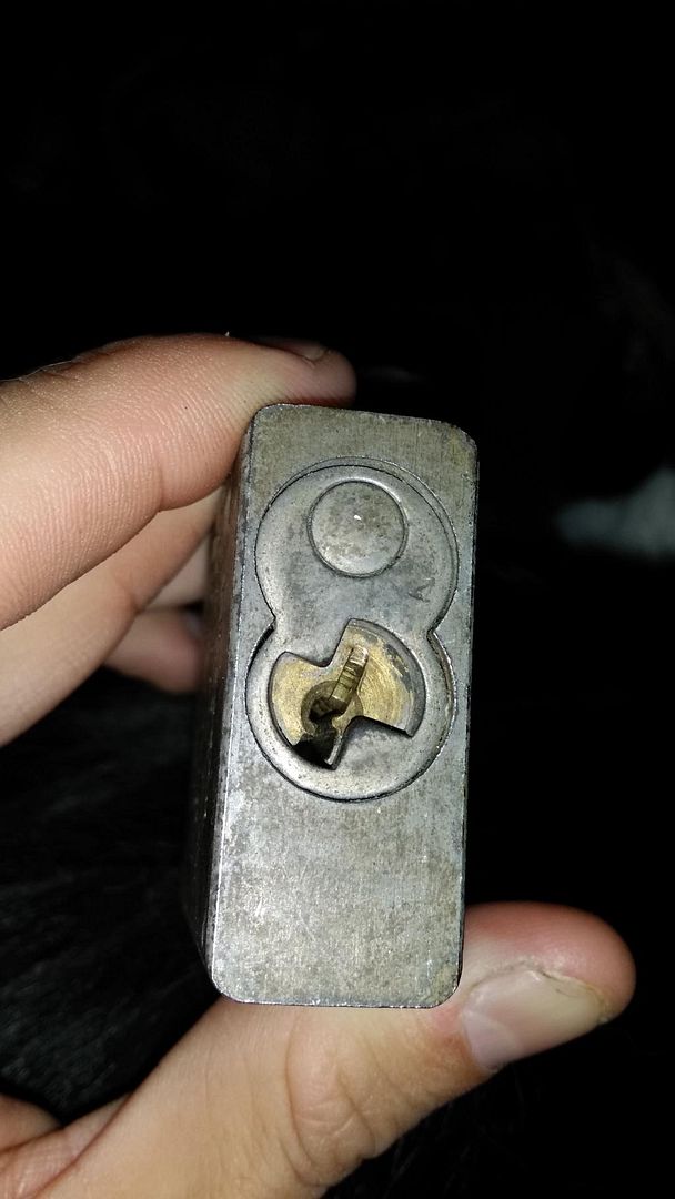

As some of you may know, I run into a LOT of American lock military locks. I found this one today with no key, in surprisingly good condition. Per the reference http://www.lockwiki.com/index.php/American_Lock_1100_1200_1300 , this was made in Jan of 86.
If this being almost 30 years old is super cool, do let me know. Something like that belongs to a collector, not an experimenting amateur like myself. The most I'd do is try to clean it up and restore it, then lose it in a box somewhere to be honest.

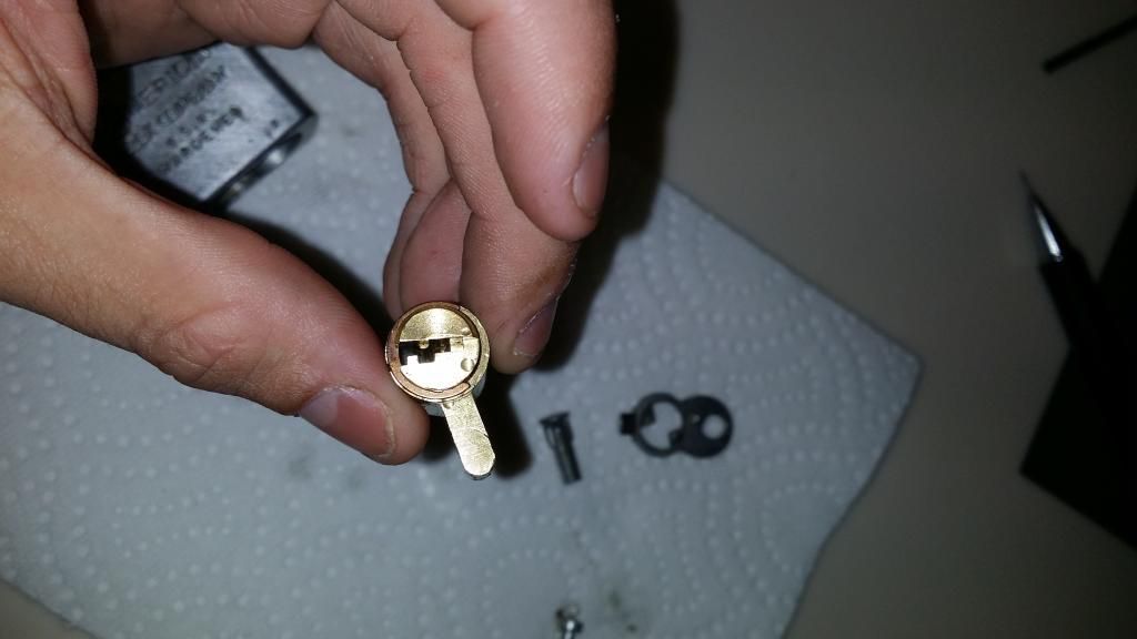

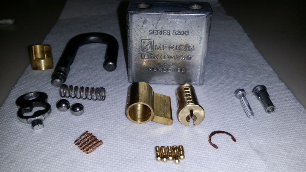

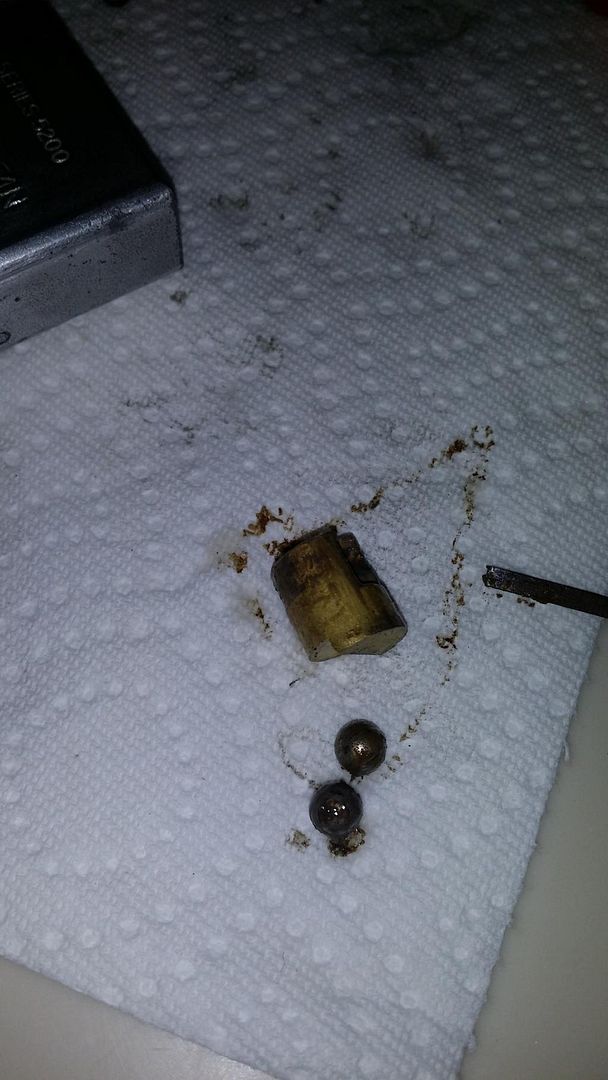

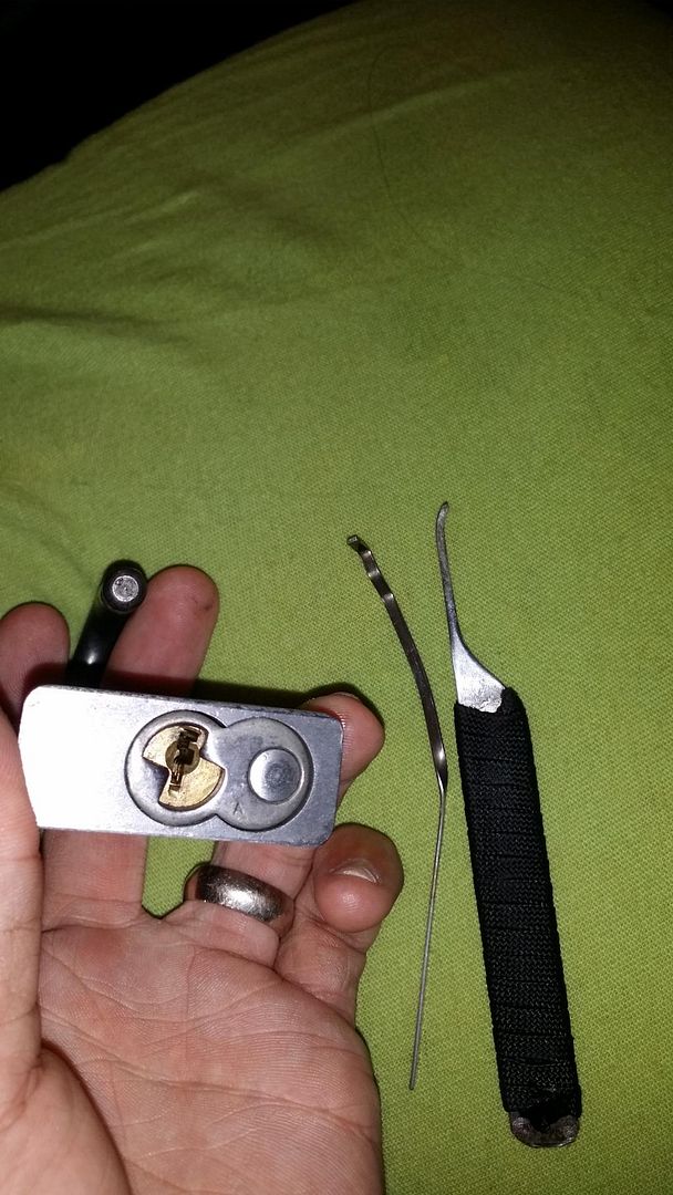

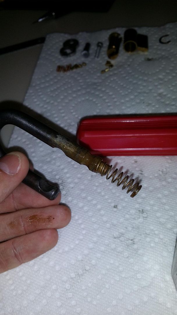

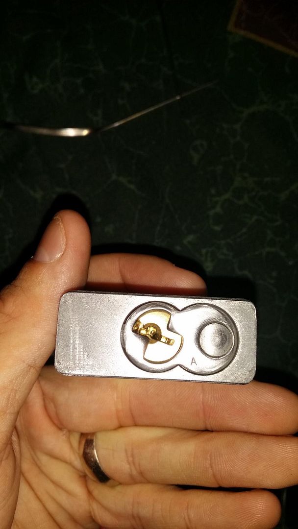

Postby Comrade627 » 1 Mar 2015 5:04
Flushed, SPP'd, torn down and cleaned. I don't have any blanks to make the key though.ImageImageImageImage[/URL[URL=http://s1383.photobucket.com/user/comradehotsauce/media/20150301_151514_zpsy6qcickb.jpg.html]ImageImageImage

Postby Comrade627 » 1 Mar 2015 5:35
And here it is, all parts are original.
