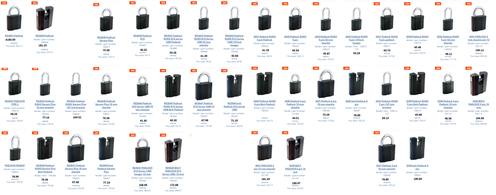

Here's a chart that I put together comparing the models in each category:
And an overview of all models available from that site:
And here are some notes that I made whilst compiling the above tables:
My Research wrote:RG = Ruko Garant
RD = Ruko D12
2*** = Grade 2 (Green Stripe)
3*** = Grade 3 (Blue Stripe)
4*** = Grade 4 (Red Stripe)
***9 are Straight shackle (Shutter) locks
***1 seems to be the standard open shutter of each series
Above also applies to the rest of the cores - D12, 6 Pin and 5 Pin
*4** and *6** may refer to the number of pins, as 6-pin cores are *6** and 5 pin cores are *5**. Garant and D12 are both *6**
Not sure why the Red stripe shutter lock (5649) starts with a 5...
... Or why the 5 Pin version is the 4549 rather than 5549...
Based on the above:
X*** = Grade, where X = 1m 2, 3 or 4
*X** = Number of Pins (5 or 6)
**X* = Unknown, may just mean "Padlock" to differentiate from other locks
***X = Lock type. 0/1 is normal open shackle, 9 is Shutter, 3 is long shackle. Not sure about 6, or if 0/1 is different.

Ok - one last update about pricing and then I'll shut up, promise :D.
If you're anything like me, a spreadsheet full of data is nice, but nothing beats seeing the correct price next to the correct padlock. Hence I've edited together (in paint, no less!) a quick-and-dirty guide to UK GBP £ prices for these locks, based on the data from the spreadsheet. Same disclaimers and caveats apply, in addition to the possibility of me typo-ing figures and/or getting locks mixed up. Use this data at your own risk!
You'll note that it's -ONLY- in £ Pounds GBP - that's cos I had to edit each one manually in paint, and while I have a lot of spare time I don't have enough time to make a USD and EUR version of it too :P. However, you can make your own! Here's a blank template (screenshots from the site) with the prices in DKK cut out. Feel free to add your own based on my figures or your own!
