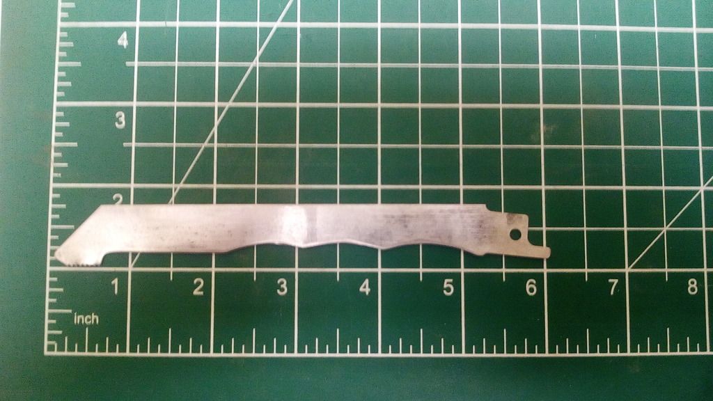

Postby blue60 » 20 Nov 2016 20:04
here is a tool I made some time ago for removing spring covers (from a Saw-all blade) use it the same way you would a piece of broken hacksaw blade :wink:
