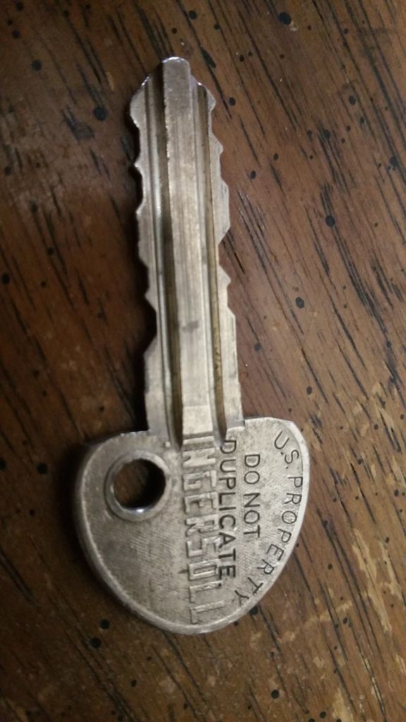

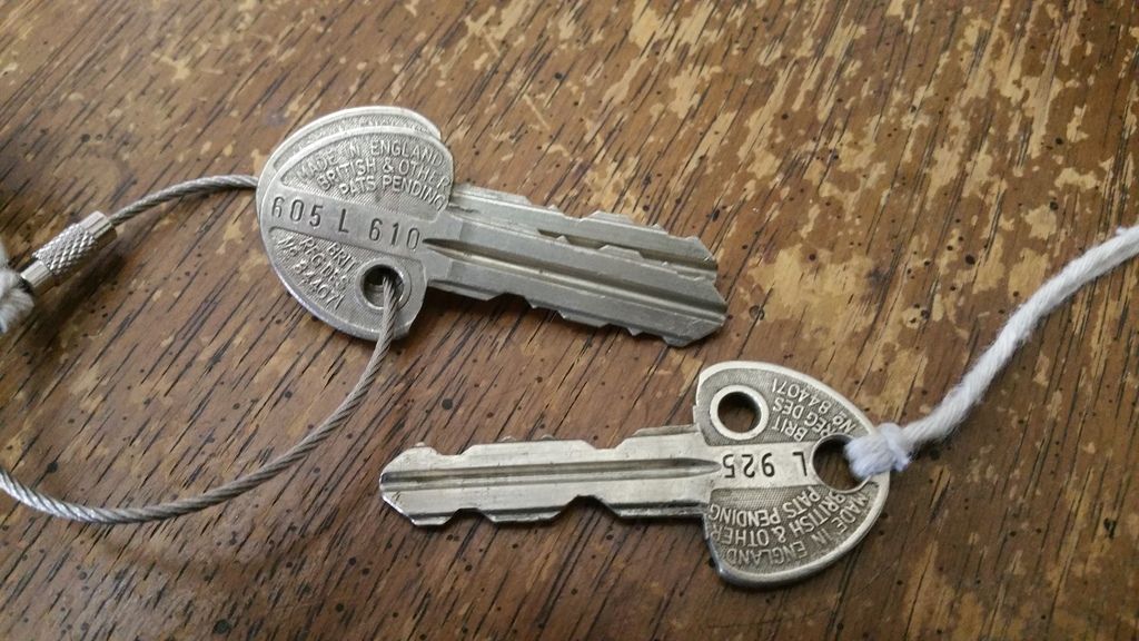

Postby cledry » 20 Feb 2017 9:21
Any idea which key section this padlock takes. I have a customer that needs a couple of duplicates.
Re: Ingersoll keyway?
Postby G-lock » 20 Feb 2017 11:21
That looks like a "L" keyway. Good luck finding a blank & please let me know if you do?

cledry wrote:Any idea which key section this padlock takes. I have a customer that needs a couple of duplicates.
I could use a few...lol. As far as i know that keyway is restricted similar to the medeco keyways for the s&g locks. Ive looked for them all over & even contacted ingersoll directly but no dice. The only way i know of to get more keys is to switch the core to something like a "S" keyway but that is pricy. These are just things that i found out when i was looking for ingersoll "L" keys so i might be wrong. I bet squelchtone or some who knows for sure will chime in & tell you for certain.

I did ask both of them when i searched last year. Maybe it was just the people i talked to & i may have made a mistake by telling them that it was a U.S. military padlock. i only asked 1 person at each place too but, they told me that the L keyway was restricted to the American military only. i also asked ingersoll if they could cut me a S key if i gave them the code just to see if they were being short with me & they said sure but with shipping it was $43.00 for 1 key. :shock: so i had to pass. Of course all of this was done via email also.

The Ingersoll site you linked to is nothing to do with the manufacturer, just a Locksmith who capitalise on the name.
The L blanks haven't been made for years, and the market is so small that none of the aftermarket blank manufacturers are interested. A couple of years ago I came across an E keyway, no blanks available, despite having been used on a 20+ apartments in a purpose built residential block. IIRC I also encountered an R (or maybe it was L like yours?)keyway, long since discontinued and unsupported, I think it was originally a US military keyway, god only knows how it ended up on a private front door in the UK.
