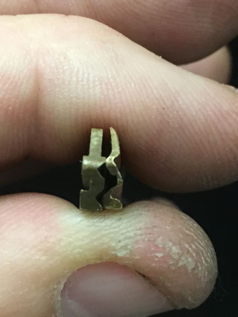

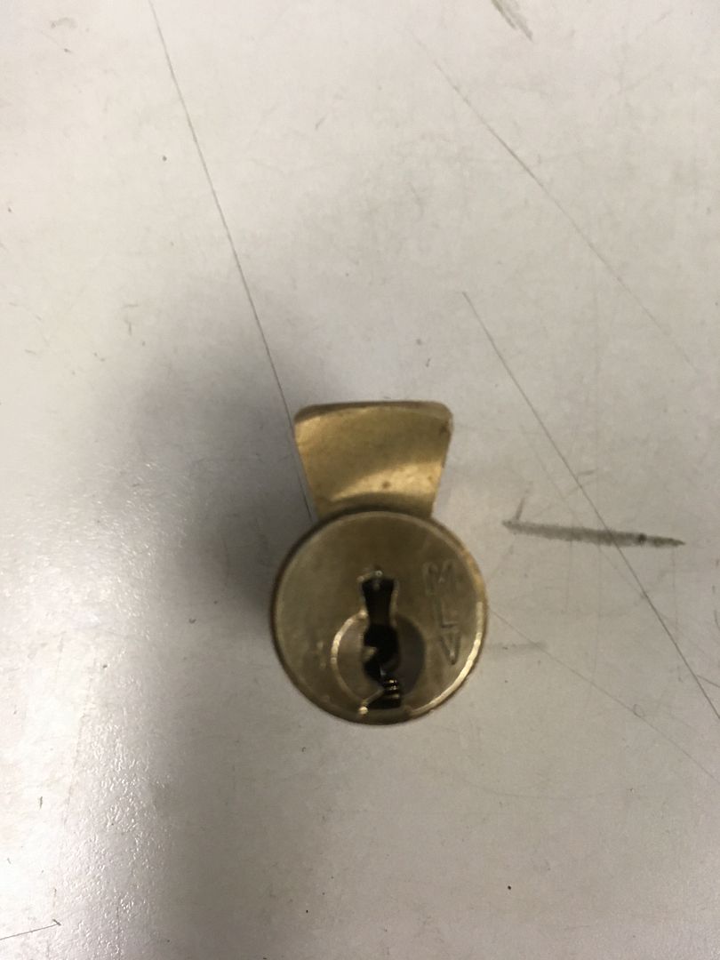

Hi,
I'm looking for blanks that might fit or close to fit these keyways. I think the Lockwood one is restricted, and I read in another forum that it may be possible to file a KW1 blank down, but it seems backwards for this one. The U-Change I managed to make a key by filing down an Ilco 1023/CL1 blank, but I'm looking for something that doesn't need filing.

Gday tpark,
You are right, the KW1 will not fit the V7 profile you have, the MLV. The best blank I found was a Silca CB34R, but alas, I heavily modified it with a mill and file to fit, it requires quite a bit of work. Unfortunately, although the V7 locks are becoming rare in Aus, In the few years I have been actively searching for them and keys to suit, I have come across a total of 1 key, which I found in an old key collection I had from a kid.

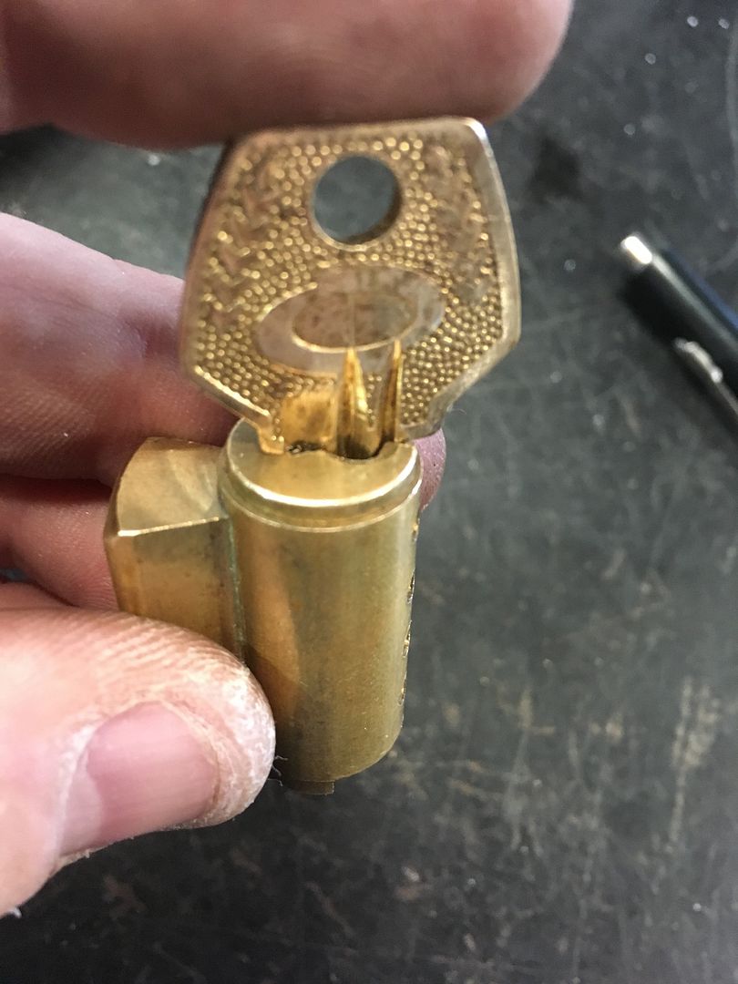

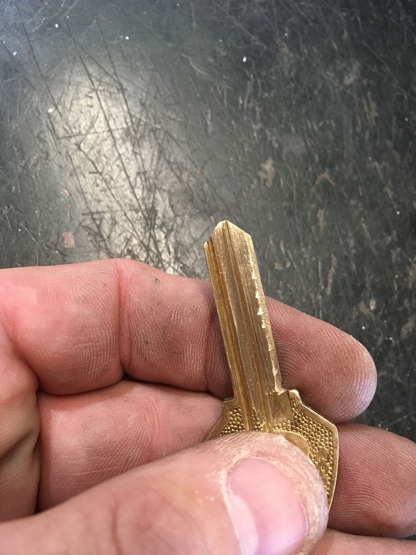

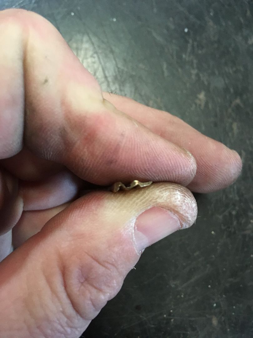

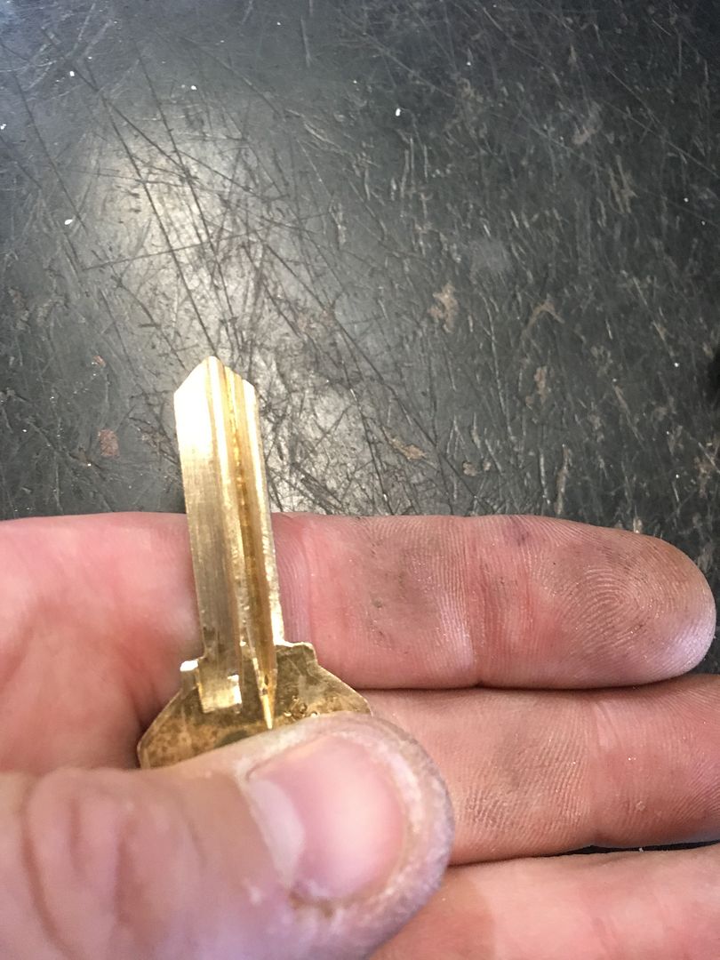

Took a page from adi_picker’s book and modified a Corbin key blank. Did not have the same blank he had so used a CO51 blank. Started out taking pics of the blank with arrows pointing to where I had to change the bevels on the wards, wards removed, etcetera.
Problem was that ended having to modify pretty much every ward, the spine of the blank, shorten the blade height, thin it, and even use a flat drift punch to bend the top of the blade so it reached the top of right wing of the keyway. So only pics of the modified blank and it working in the lock after being cut.
Key blank that has not been modified on the left, modified on the right.
When I get home will reassemble the padlock with this core that I got from adi_picker. Thanks again, adi!

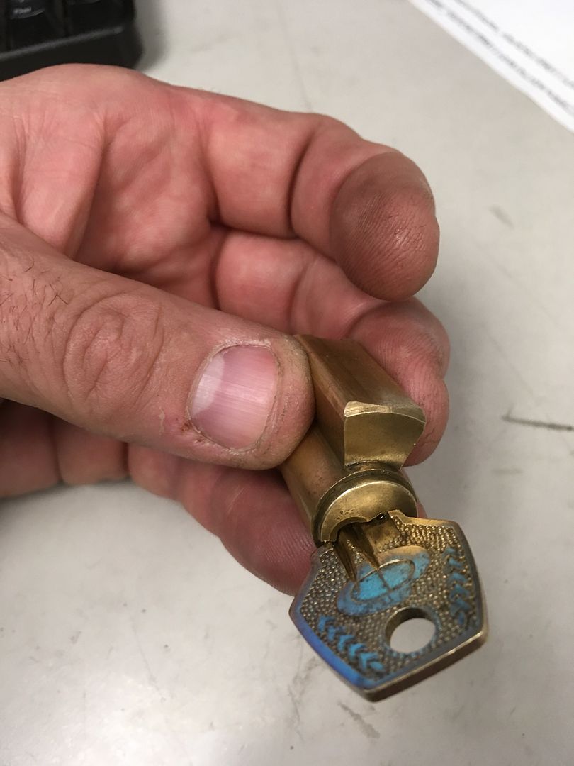

Postby MacGnG1 » 23 Oct 2017 18:26
you mean a V7 blank like this:
edit....
you mean a UCHANGE blank like this:
MacGnG1

Postby GWiens2001 » 23 Oct 2017 19:51
Thanks, TPark. :D It took about 90 minutes to get the key to fit in the keyway. All hand filing. Then it was fairly quick to file the key for the pins.
MacGnG - those two blanks look like you had them machined. Both will require fitting - the Lockwood will require extensive fitting. The groove in the top will need to have some sort of wedge pressed into it to give the top parts of the blade the "V" angle needed to fit around the top warding, then all the side milling will be a lot of work. Good luck with that! The U-Change locks only have minimal warding, so it should be fairly easy to fit. Appreciate you sharing the pics of them! Nice to see someone 'coining' blanks. :)

Postby MacGnG1 » 23 Oct 2017 21:02
The u-change blank I got from Lauren a long time ago.
The V7 blank I got from a guy in Australia that actually was contracted out by Lockwood to make small batches of blanks when less than 250 keys were needed from Lockwood for the V7 cylinders. I also got an uncombinated V7 padlock from him.... Will post pics if anyone is interested.
