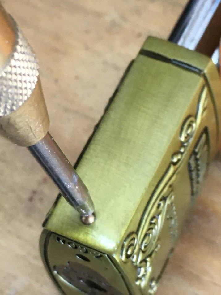

On the side of the lock, down low there is a poorly fitted brass pin. You will need to remove this pin for disassembly. The lock is low enough quality that I'm not too worried about it qualifying as DE.
Use a center punch since the pin is round surfaced, then drill it out. It is only a few millimeters long - just over the width of the walls of the lock body.

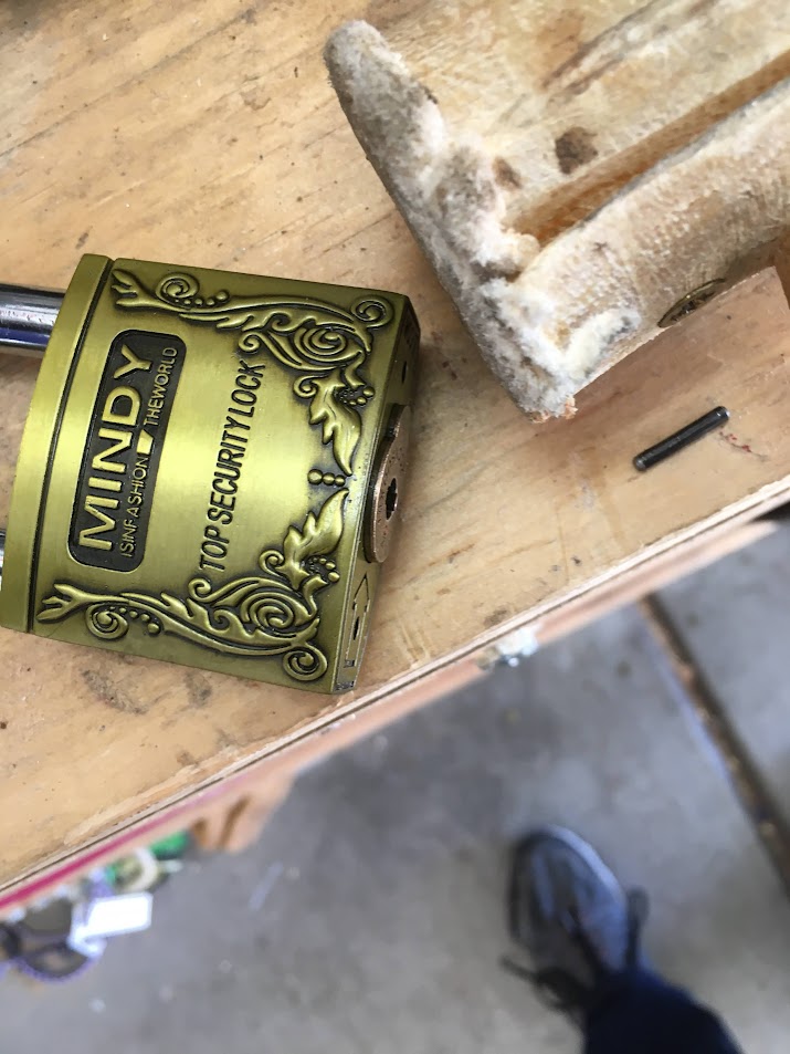

Now tap the side of the lock body above the hole with a rawhide or rubber mallet. A long steel pin comes out of the hole. That is what keeps the core in the lock...
... along with some adhesion from the clear coat finish. Rap the corner of the padlock a couple times with that mallet.

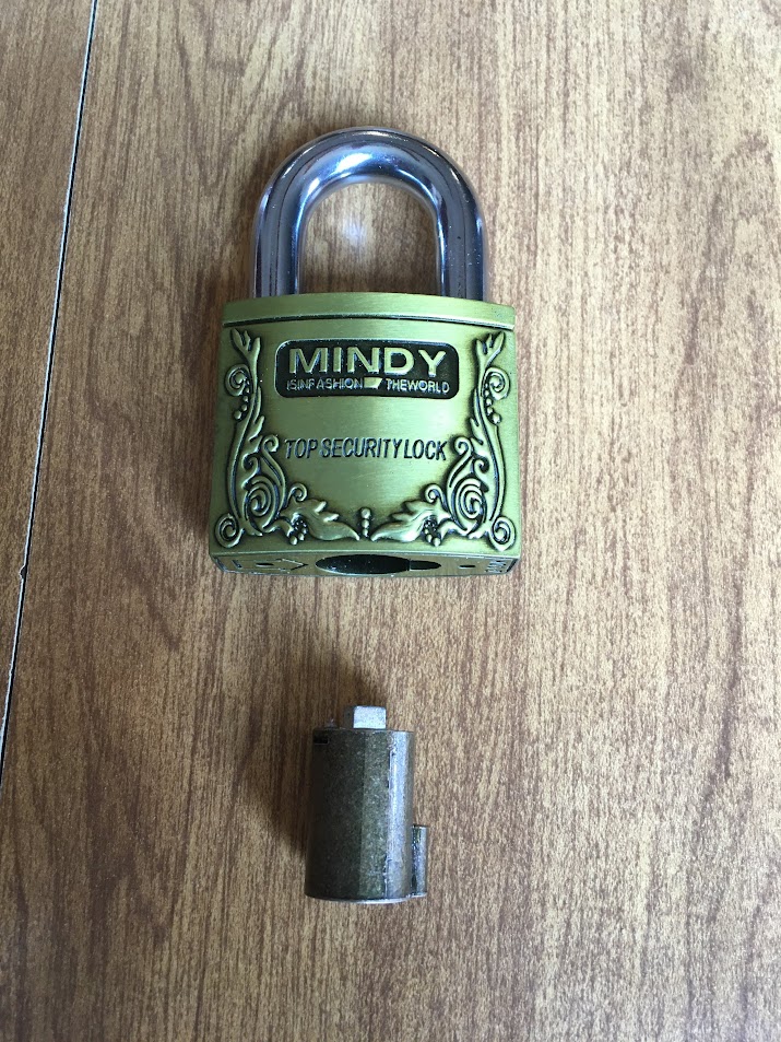

And here she comes! You may need to use the key or a hook to help pull out the core.
Core removed!

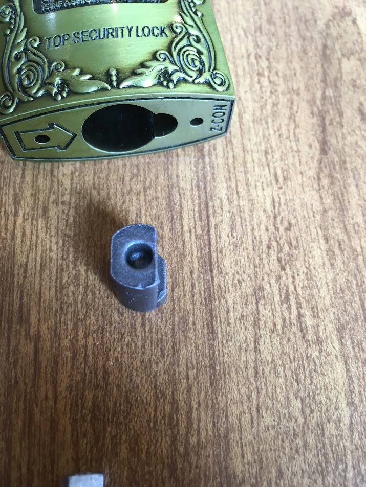

The only parts left have to do with the core. So let's examine it.
The tab has a hole in it. That is where the long steel pin fits in to retain the core.

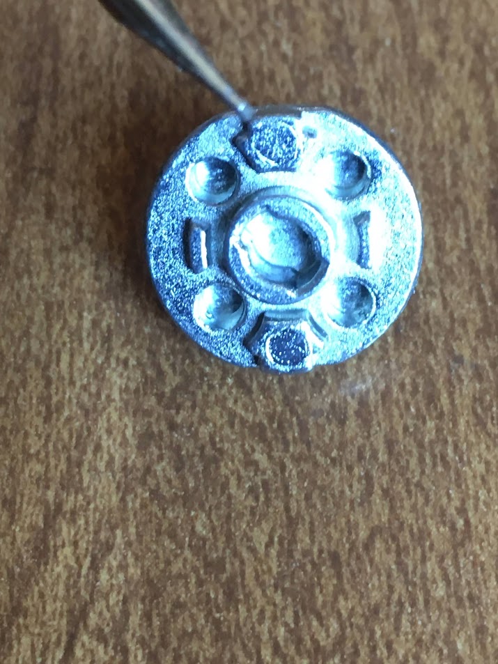

The driver that turns the actuator is held in place by a snap ring.
Remove the snap ring with a dental type hook pick and a fair amount of curse words, taking time to wipe off the blood as the hook pops loose repeatedly and hooks your thumb.
The driver will now be pushed up by the five springs inside the core. Remove it.

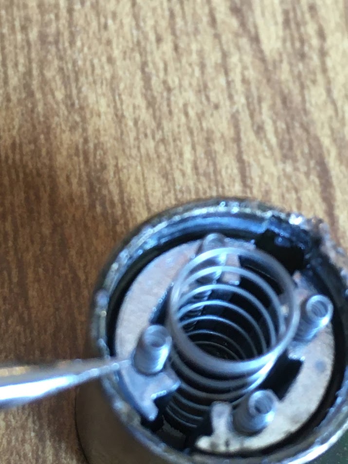

Remove the large spring
It fits on the driver like so:

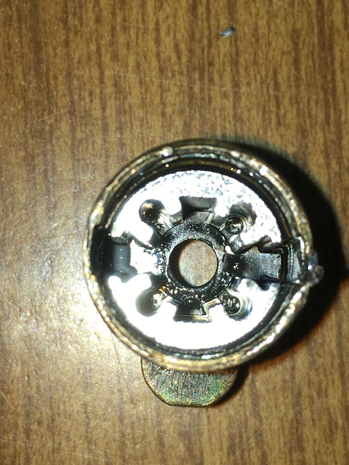

Now you can easily see the top end of the keyway, the four smaller springs and the innermost locking disc.
A better shot.

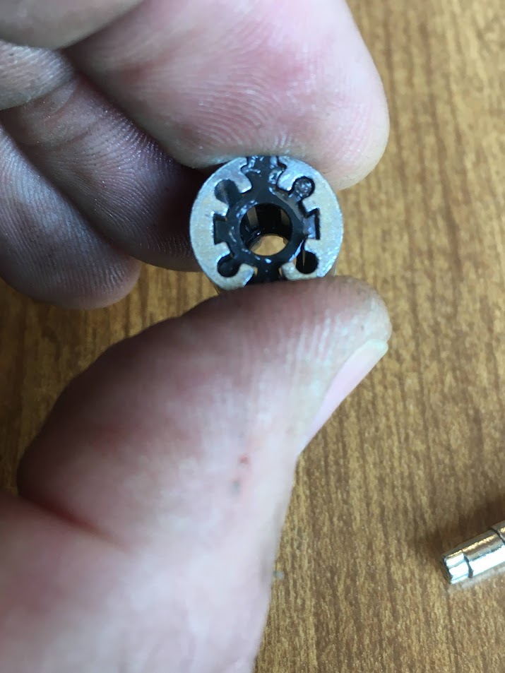

With the carrier removed, you can see the three combination disc ends sticking out from either side of the carrier. More on that in a moment.
Looking in the core where the carrier was, you can see a couple grooves going all the way down, and three more going clear around the core.
The longitudinal grooves are where the combination discs slide when the key pushes them against the springs. The three grooves here:
Are where the key pushes each combination disc to allign with when the correct key is used. (Or picks :twisted: )

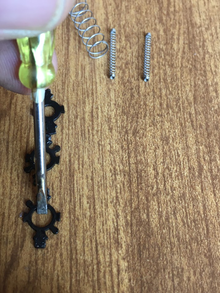

Pull out each disc, keeping track of the orientation.
The first one removed is the innermost from the keyway. It has the smallest center hole for the narrow tip of the pagoda key. It is the one driven by the large spring.
Lifted the second, middle combination disc to the top of the carrier so you can note the top right and bottom left corners have tabs, but the other two corners do not. These two tabs are what are driven by two diagonally opposite small springs.
Also note the angled tabs on the sides. These are to keep the disc from flipping sideways in the keyway.
The third disc, which has the largest diameter center hole, has tabs on the other two corners. That is important when reassembling, or the discs can't be pushed properly to their unlocking location.
A small screwdriver is used to show the difference in sizes of the center holes.
