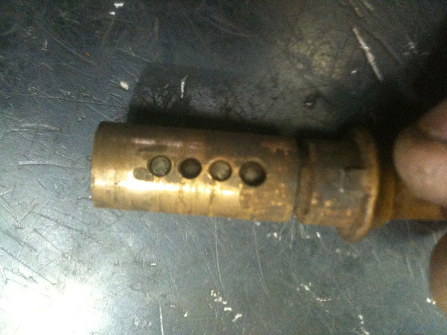

This is the plug part of the shackle.  Pay particular attention to the fourth hole. The fourth hole has a larger diameter key pin which can not be lifted  above the shear line.  This works as a kind of adjustable warding.  The tip of the key will need to be filed down to this level in order to fit the key fully into the lock.

Correct. The plug and the shackle is one piece. The plug IS the heel side of the shackle.. There is a tab on the heel side of the shackle and a point on the toe side of the shackle, both of which prevent the shackle from turning until the plug/shackle is lifted high enough to allow the tab to clear the notch in the padlock body.
This is a picture of the plug/shackle. If you look at the end of the plug/start of the shackle, you can see that tab that fits into a notch in the lock body. The groove you see there is where the flat spring fits to prevent the shackle from being removed unless the bushing is removed and the spring is slid over.
