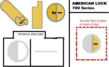

Postby MudSlinger » 29 Jun 2005 0:35
I too was defeated by this same lock, or one very similar.
when I got desperate I decided to ask a friend for advice, He told me there is a special bypass tool you can slip in through the keyway past the plug and turn the cam with out touching the pins
this of course sounded great so I went online, saw the picture of the 40 dollar tool, printed it out and made my own.
when I tried to put it to use(if u can tell by the theme of this post) no luck.
-Long story short I drilled it out (tough to do btw broke 3 bits)and found my problem, as well as anyone who is thinking of using a bypass tool s'problem.
Im profficient with paint! :P lemme know if anyone else has run into this.
MudSlinger
Posts: 52
Joined: 22 Apr 2005 9:45
Location: Dallas, TX

Postby keysman » 29 Jun 2005 3:09
The commonly accepted method of bypassing with the hardened steel plate is to sharpen the tool to a sharpe point (chisel point) and bend the plate out of the way.
Never tried it myself so I can say first hand.

Postby mouseling » 29 Jun 2005 20:28
The Security disk is often called a wafer. The wafer must be broken - eg - punched through by a sharp blade or a special wafer breaker tool.
Then you can use the by-pass tool to open the padlock.
