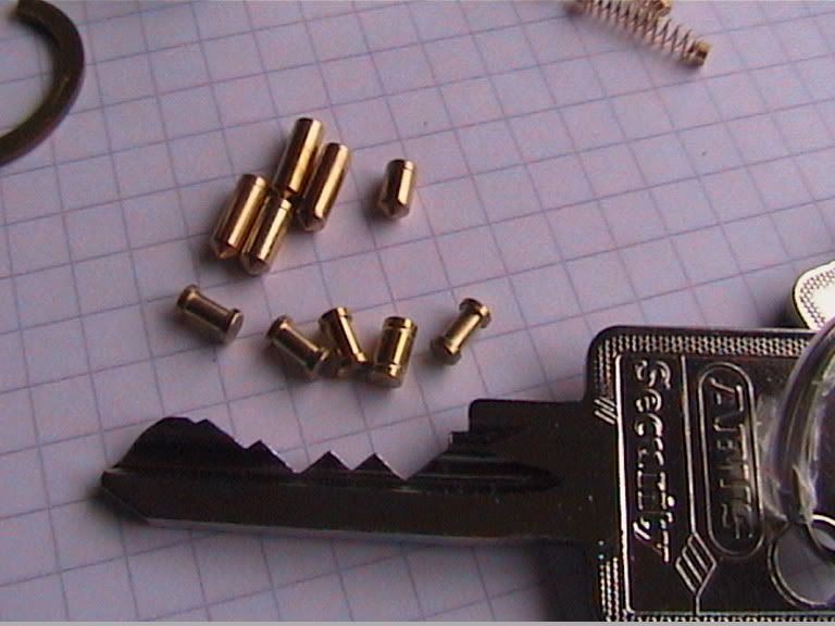

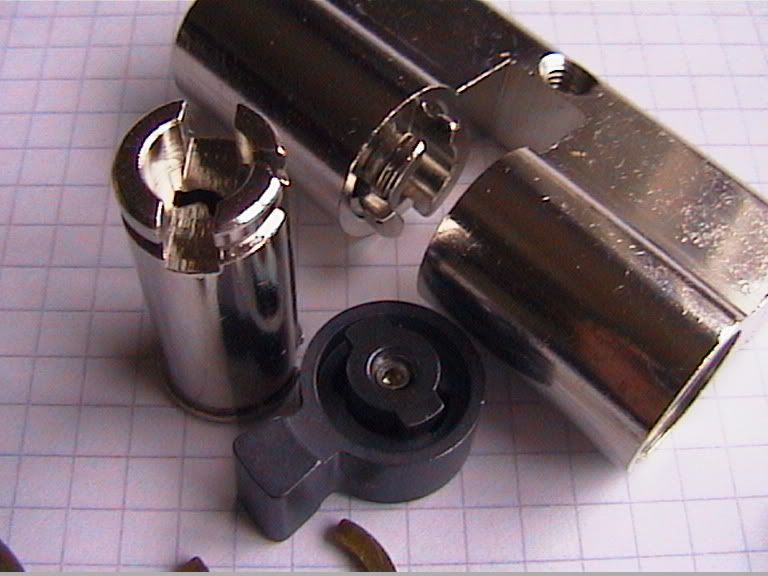

Postby Keyring » 18 Sep 2005 11:36
Probably should have stared another thread for this in European Locks, but anyway, I took the Abus C83 cylinder I mentioned above apart to find out why I was having problems. Nothing special in there but someone might be interested. The site above who were selling them said mushroom pins, but as you can see there are 4 spools.
http://img.photobucket.com/albums/v217/keyring/Abus_C83_2.jpg
Two things interested me. Firstly the non-spool top pin has a shallow groove at each end. Secondly, of the 5 bottom pins, 3 have similar very shallow grooves at the top end, but the two longest pins don't. Theories?
http://img.photobucket.com/albums/v217/keyring/Abus_C83_1.jpg
I think my problem may be in assuming which pin would be a non-spool pin. All my Abus padlocks put the non-spool pin at the front. I don't know which one it was here, they all fell out so quickly!
(By the way, when I say top and bottom, this is when the lock is upside down. Euro's are the other way up to the way I usually think - sorry.)
Keyring
Posts: 487
Joined: 23 Mar 2004 8:01
Postby treboR » 18 Sep 2005 12:29
Keyring wrote:Two things interested me. Firstly the non-spool top pin has a shallow groove at each end. Secondly, of the 5 bottom pins, 3 have similar very shallow grooves at the top end, but the two longest pins don't. Theories?
They look to be serrated. I haven't seen any locks where all of the pins were serrated. They probably do this to make it harder to pick.(hard to tell which pins are serrated and which are not without looking)

Postby Keyring » 18 Sep 2005 13:09
I suppose I was wondering too, why you would serate a bottom pin (nearest the key), as you would have had to have raised the pin too high already for it to take effect. But then some people claim to pick backwards (push them all up first and carefully let them down one at a time. Never worked for me. :)
