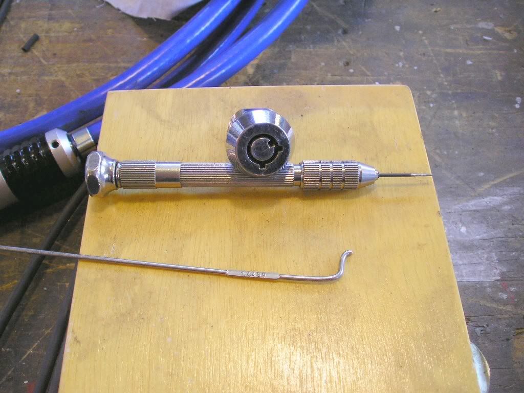

Postby Wolfy » 26 Jul 2006 16:47
Its possible to do it manualy,
Ive done it.
Here some photo's of the tools i used,[img]
http://i84.photobucket.com/albums/k23/c ... ubular.jpg
[/img]
If you dont want to repick the pins
shove a plastic tube in when picked and itll hold the pins in place.
