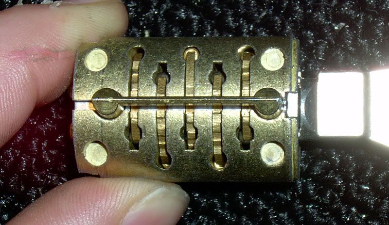

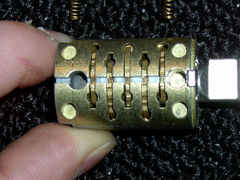

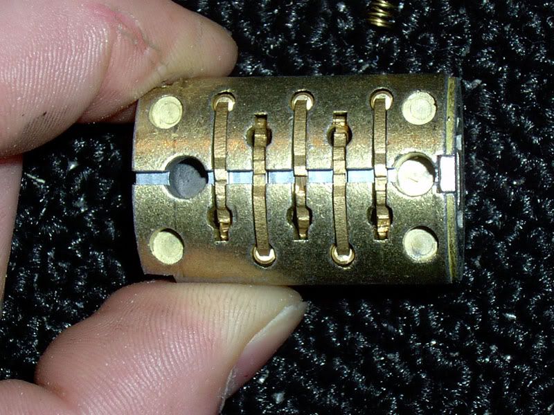

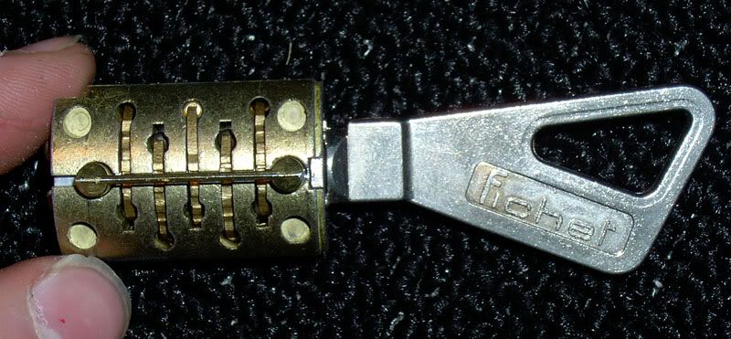

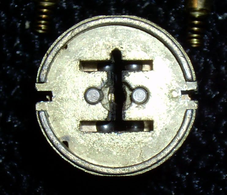

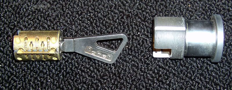

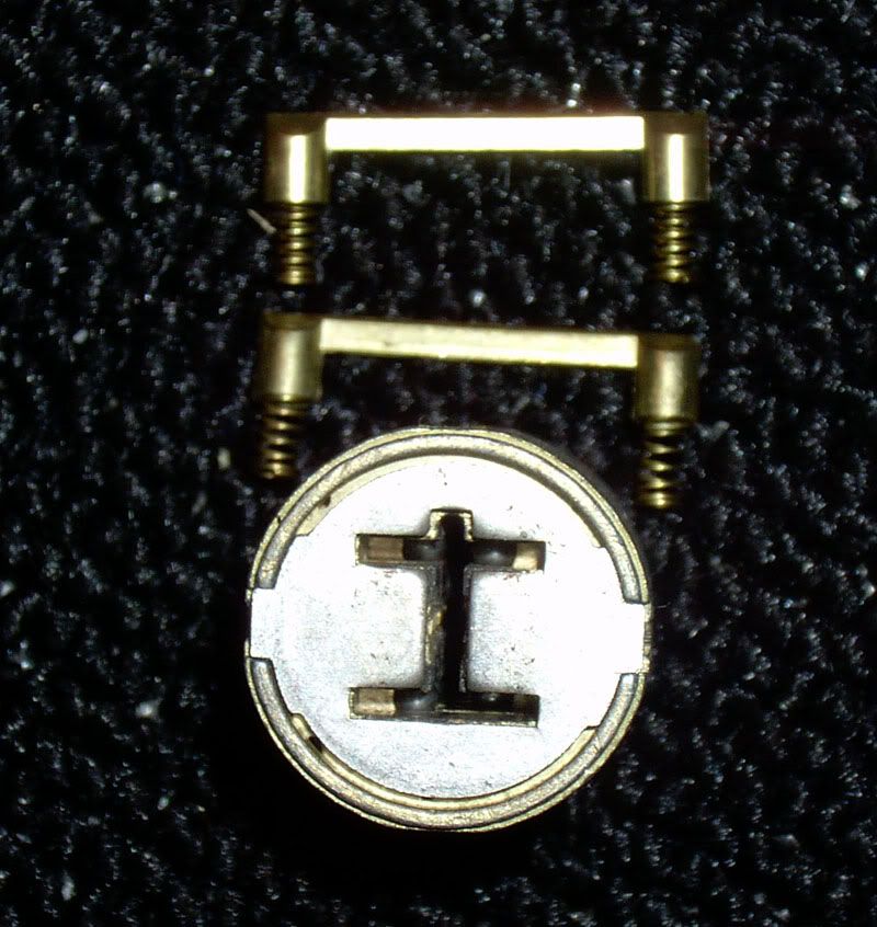

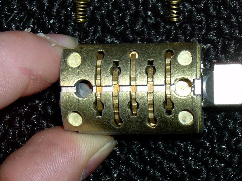

I got a Fichet 480 mortise cylinder in the mail today. This is a unique lock, which uses 8 (4 per side) pivoting wafers controlled by a dual sidebars. I got this lock with 3 keys for $40, but one of the keys doesn't work, and the keycard is shattered :evil: I might have to send this lock back to the seller, so I figured I'd at least take some photos in the case that I do have to send it back.

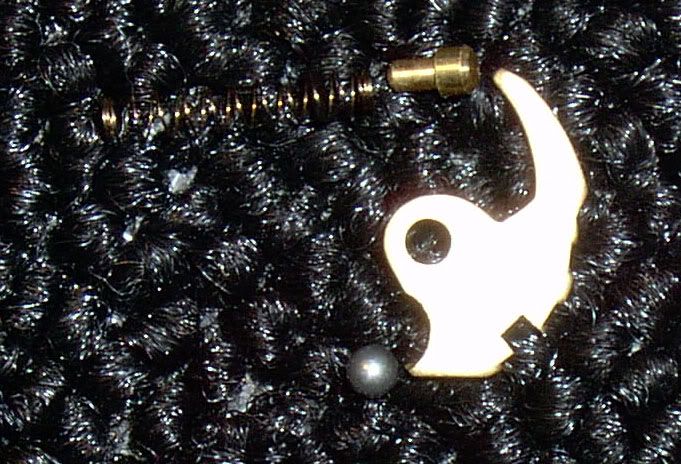

A wafer assembly:
First person who figures how you can get the wafers out wins the prize :wink:

Postby TOWCH » 8 Apr 2006 15:48
Punch out the two center rods?
TOWCH
Posts: 1587
Joined: 20 Jul 2004 0:19
Location: Oregon
Postby n2oah » 8 Apr 2006 15:55
Yay, you win the prize. It took me a minute or two to figure out how to get the wafers loose.

Postby eric343 » 8 Apr 2006 16:09
Nice photos. That's the first time I've really understood how the "H" lock works.

Postby mh » 8 Apr 2006 17:00
Great photos! An interesting lock design, too. Pivoting wafers with false gates, and balls to reduce wear & tear...
But why does the 3rd key not work? Simply a key for another lock, or worn down?

Postby n2oah » 8 Apr 2006 17:38
The third key doesn't put all of the wafers into position. It puts only 3 out of 8 wafers into the proper position.
