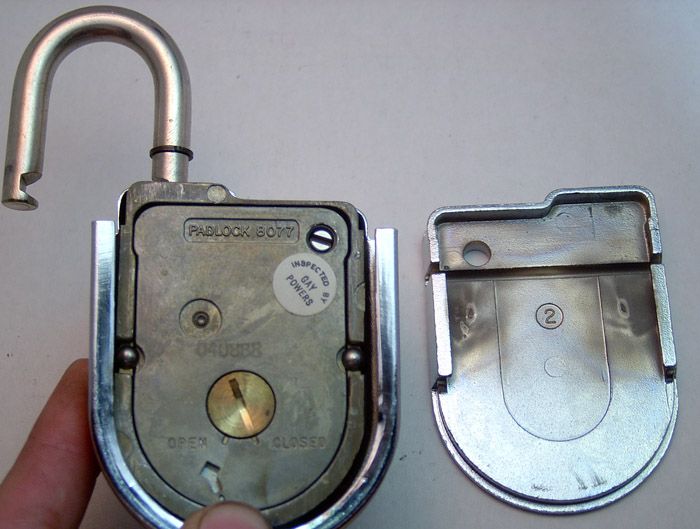

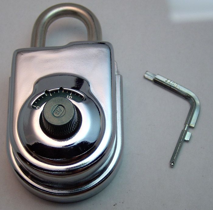

The lock and change key:

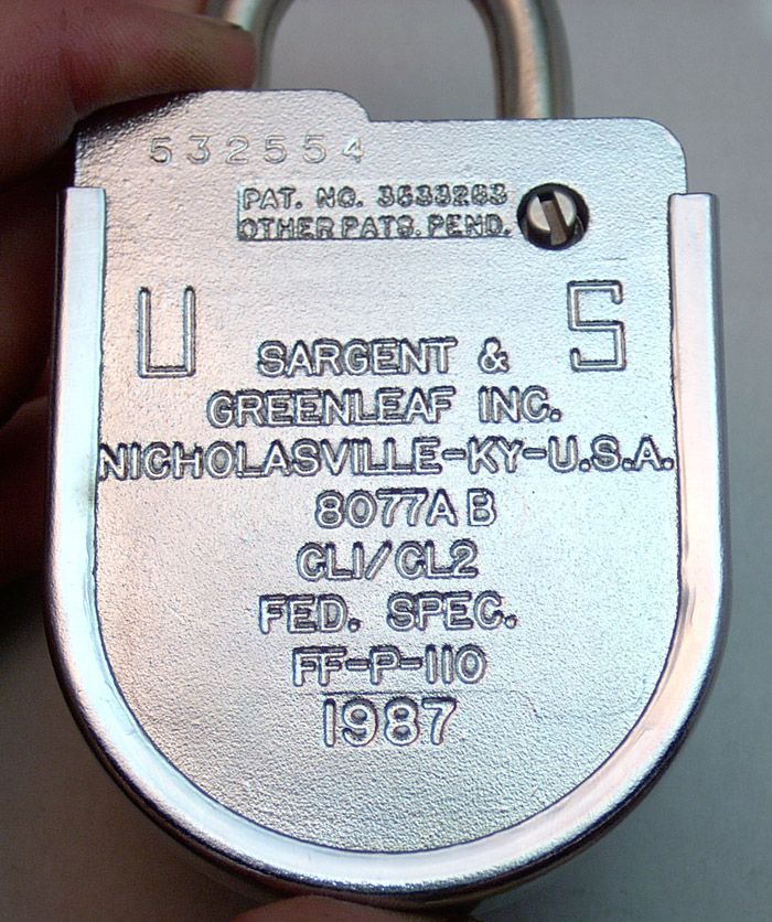

The back:

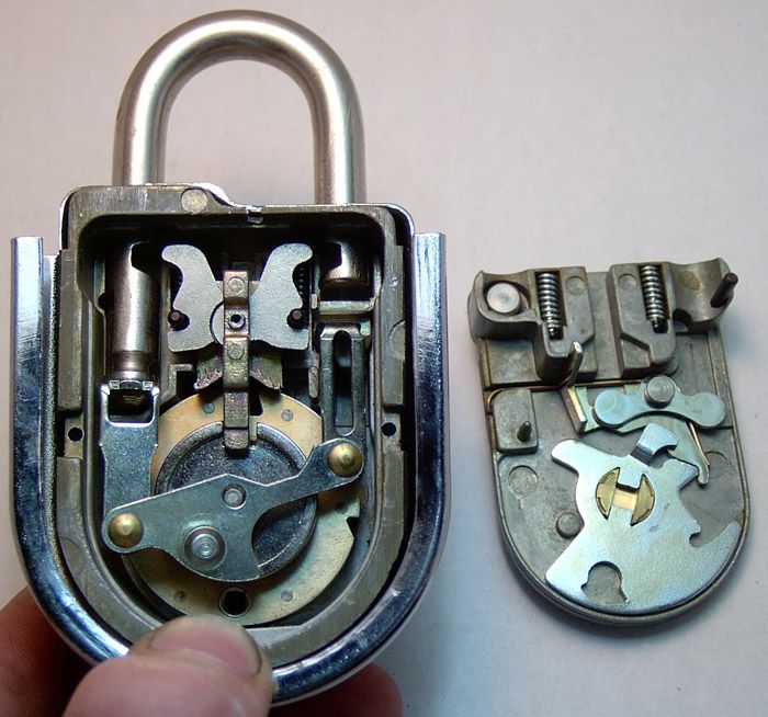

Dial the combination in and pull up the shackle, then you can screw in the screw at the top right and slide off the back cover:
Hmmmmm:

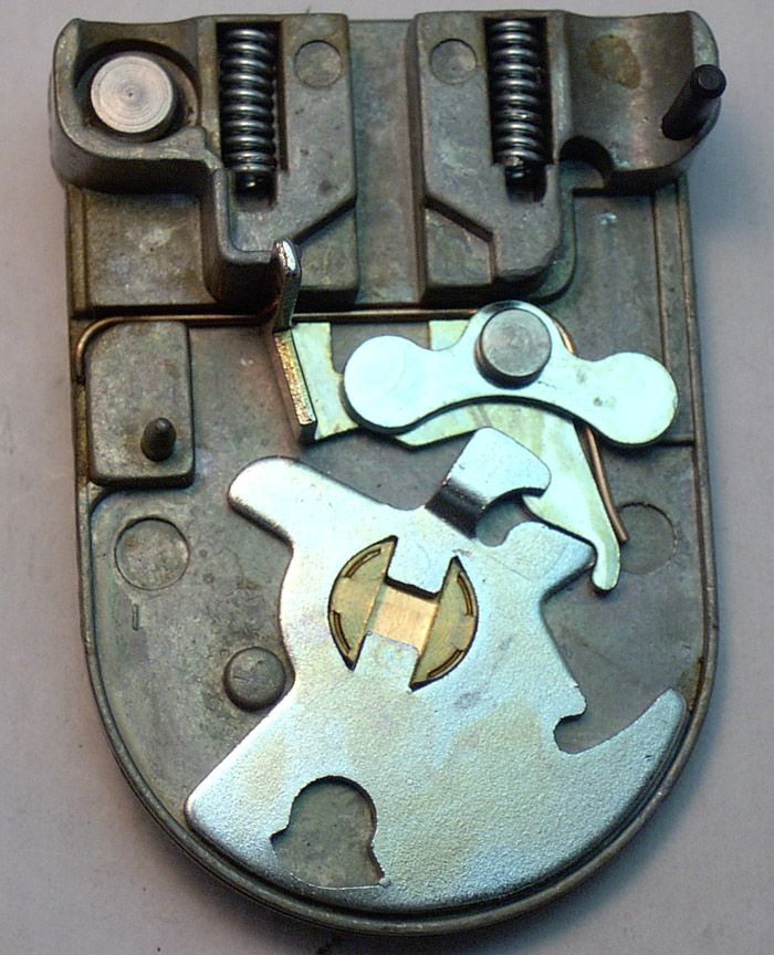

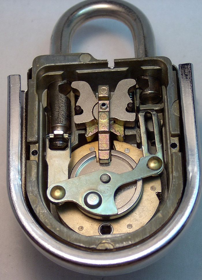

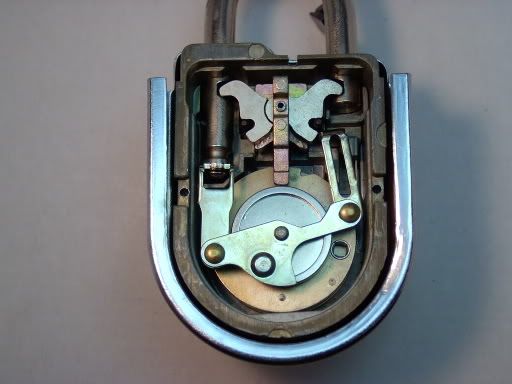

You can't take this lock apart without some grinding and prying, and here is the lock after the grinding and prying:

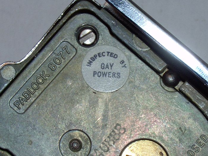

Close up of the back plate:
Close up of the body:

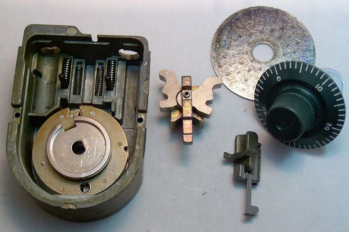

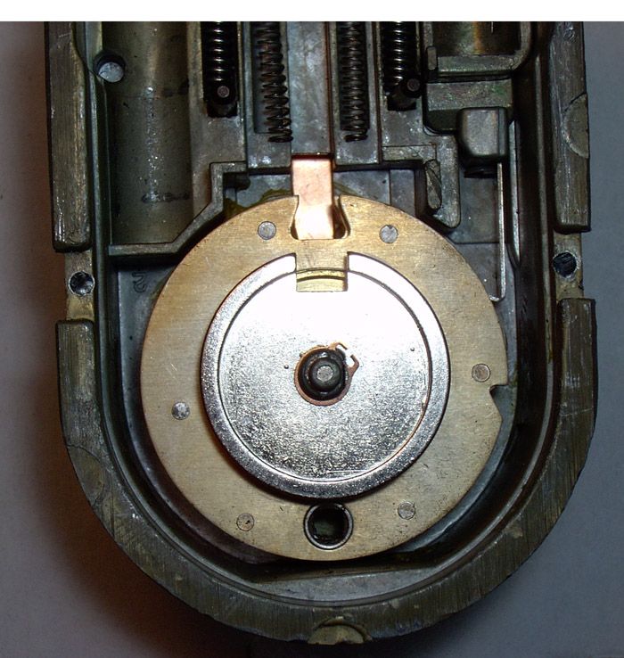

The discs:
Various parts:

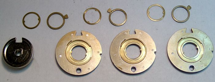

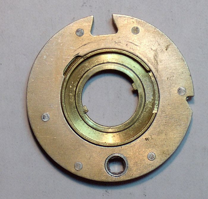

The discs in order:
A single disk:

Postby maxxed » 19 Jun 2006 23:25
Inspected by Gay Powers :oops: sheeesh

Postby digital_blue » 19 Jun 2006 23:32
maxxed wrote:Inspected by Gay Powers :oops: sheeesh
Bahahawhahawhawhawhawaahahahaa!

Postby p1ckf1sh » 20 Jun 2006 5:14
That name is worse than "Dick Trickle". By lightyears.
