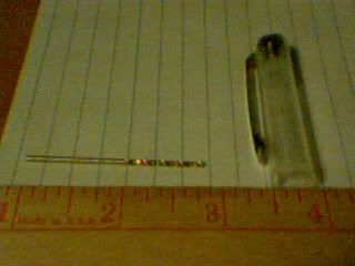

Postby Ofnir1 » 6 Apr 2008 23:52
@ illusion
Actually, that is great info! I was looking around the house again today and found some small drill bits that look thin enough to pick a tube lock. I think if I combine the ideas you posted, and the small drill bits, I could probably make a tube pick :D
Here's a pic of the drill bit and a different pen cap:
I don't think the pen cap will work though, but I'm gonna find out soon enough lol
