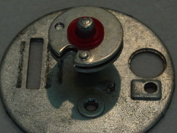

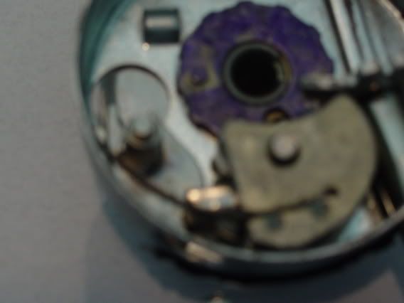

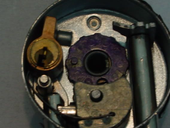

Postby What » 16 Jun 2006 17:37
well, i have pics!!!!
i was bored today(school is out) so i ground the back off the lock.
next the back plate removed.
and the back plate.

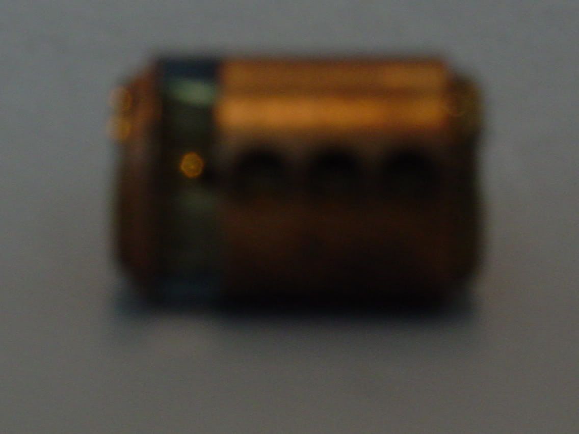

cylinder(sorry for the blur) is a 3 pin masterlock core.
locking mechanism, you can see the extra "lever" that the cylinder engages the hasp for the shackle with.

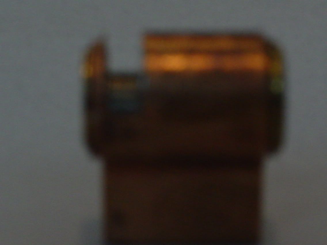

Postby what1sth1s » 30 Jun 2006 0:43
just thought i test my new camera out. heres a better pic of the 4 pin cylinder lock inside a masterlock padlock.
what1sth1s
Posts: 44
Joined: 19 Jun 2006 21:23
Location: Canada
Postby Shrub » 30 Jun 2006 11:40
Thats definatley a 4 pin is it?
Postby unbreakable » 30 Jun 2006 11:59
It is a 4 pin, and not a three pin.
I have picked this lock a few time, but got bored quick. I just used a small tension wrench, and a straight pick, which seemed to work quite well. Just insert the pick, jiggle around a little, and presto, it's open.
Although there are only three holes in the bottom, there is another pin right under where the large cut out bit is. Hope this makes sense
:P :P
