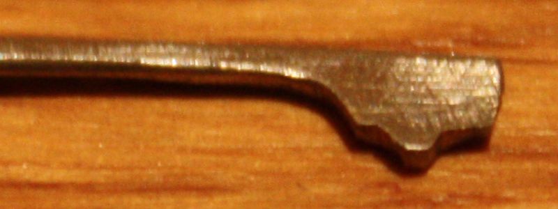

I tried the SandingBLOB with this bad shaped pick. I say bad shaped because I made a little mistake with the file, so the tip is a little off centre.
I filed the tip by hand and finished the shaft with the world famous wet grinder. This is the rough pick (never touched by sandpaper).
Then I put the pick in the drill, like a normal drill bit, and dipped it into a plastic bottle filled with sand and water. I added water to keep the sand down and avoid the necessity to wear a mask. Yes, I was wearing safety glasses.

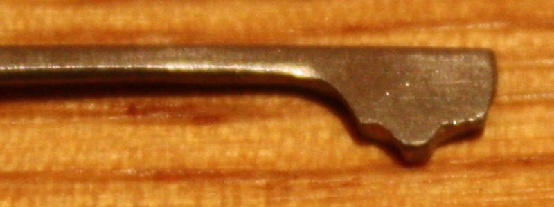

After a few seconds I stopped the drill, reversed the direction and run it again. The pick looked exactly the same as before. THen I decided to insist and let the drill run for a minute. After reversing the direction and another minute or two I got this result.

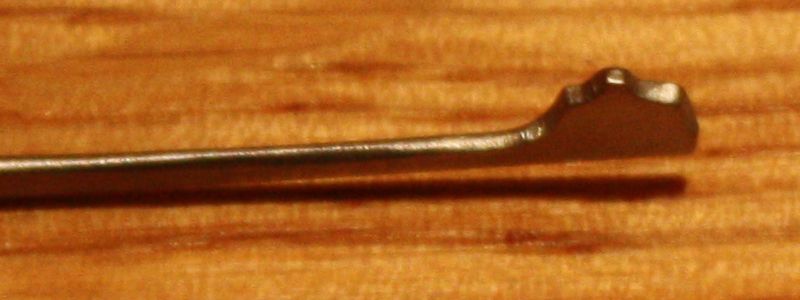

Another point of view
The SandingBLOB is not as brilliant as I thought but it can work. The main problem is that it's too gentle: it can't be a substitute for sandpaper. Any idea about improving this method?

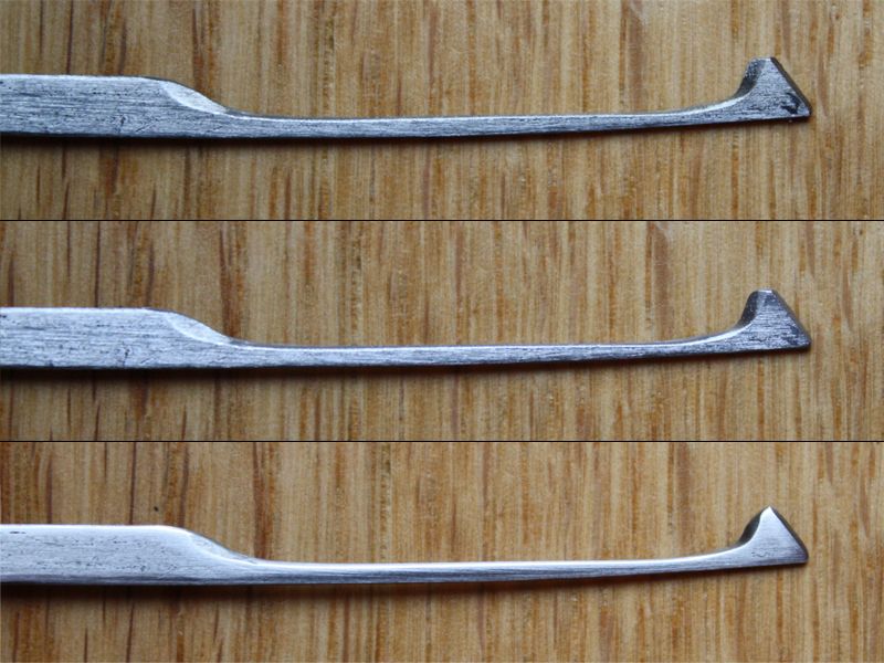

I made another experiment with the SandingBLOB: I added some soap to make it more viscous.
I roughly shaped an half diamond with my wet grinder so it's a more known shape and it's easier to understand what happens to the pick shape. The pick edge is more or less 45 degrees because it's for dimple locks.
The first picture shows the pick just after the grinding process.
The second is the result after less than 10 minutes in the SandingBLOB (4 minutes CW and 4 minutes CCW).
The last picture is the pick after 10 minutes of sanding with a piece of 600 grit wrapped around a wood stick.
You can clearly see the SandingBLOB effectiveness compared to a classic sanding stick within the same time.
In the SandingBLOB the pick is just a bit rounded but still not functional.
Even with a sanding stick 10 minutes aren't enough to properly sand a pick, but are enough to have a working pick.
I think my experiment ends here :( I was looking for a different way to sand a pick, this was funny but not useful as I thought.
