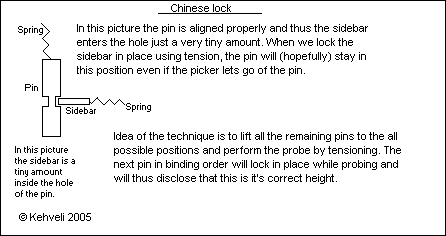

Here is my thought of a way to decode/pick the lock.
Don't limit your thinking to using tension to bind pins. You can use it to lock the sidebar where it is (thus locking the binding pins in place if they are at the correct height).
This is just theory though.
My method is based on 'probing' the remainig pins for each height. When one pin is probed you continue the probe all the un-probed pins (while still maintaining the state of the already decoded pins) until the lock opens.
1. Lift all pins to first height (dont do any tensioning here)
2. Apply aggressive tension
3. Let go of the pins (maintain the aggressive tension)
4. The pins will fall down (if one doesn't fall down and stays at the set height, you know that this pin's correct height is the one probed and you have decoded this pin, see below on how to proceed then)
5. Release tension
6. Lift all pins to the next height to probe
7. Go to step 2
After you have decoded one pin, then do the procedure but with lifting all BUT THE ALREADY DECODED pins to the heights. Set the decoded pins to their correct positions.
The tool required to do this would probably be VERY hard to manufacture because of you should be able to control each pin's height at the same time. It would probably need to be a sputnik-tool-like.
The advantage of this method would be the fact that the user does not need to have very sensitive fingers. It would just be enough to feel if a pin is locked at a certain position.
What do you think of my method suggestion? Should I make an animation of this procedure?

I think your idea is good and could work. There is really no room to work from the bottom because corrisponding to the pins in position "9" (lowest ones) the key has almost a hole. The tool would have to work from the sides, I would think to 3 "L" shaped tools per side one for each pin. Tools and machining required put it out of my possibilities and skills.
Your drawing is correct, the only difference is that the contact points between pin and the sidebar are belveled.
