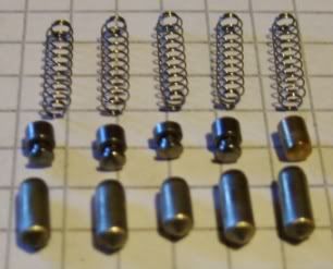

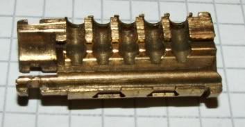

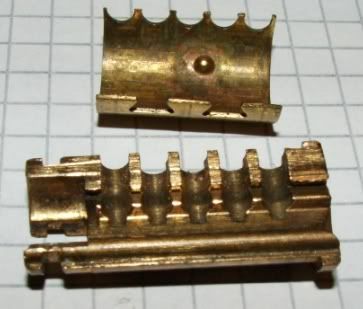

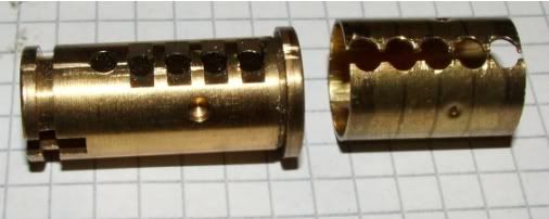

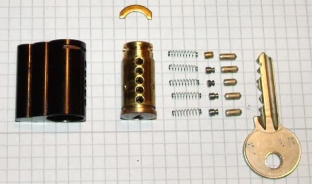

this is a brakedown of the ruko safety plug! most of my new ruko locks both 5 and 6 pins (door/padlock/mailbox) use this system! (and it is a b.... to pick) the plug has one standard pin (the last one) and the rest is single-grooved pins made specially for casting a groove in the plug! the plug looks like a standard (???plug???)pluck with a tube around it, if you remove the tube you will see a bit of metal has been removed at the top of each pin-hole! this makes a gap with the tube for the groove in the pin to catch a lock it!
1. all the parts
2. the shell (this is from a series 500 padlock)
3. the plug with the tube in place
4. the plug with tube removed
5. see-trow of the plug
6. the pin stack
7. close up of the safty pin (single-grooved pin)
as you can see this lock calls for very light tention an a lot of luck :D

Postby UWSDWF » 4 Feb 2007 8:57
did you just cut the cylinder in half?
Postby net-rom » 4 Feb 2007 9:01
yes with a hacksaw (but not the plug form this lock i had an extra) :)

Postby JackNco » 4 Feb 2007 12:53
argh!
These things seem to be a permanent thorn im my side!
Ive got an Assa Ruko2 padlock, same core but i have a 6pin version with compensated drivers (all spools) and a completely different key way. Its also pined for at least 3 keys. if i get the chance ill take some pictures and post them up.
every time i think i know enough about this lock a new model pops up.
Great pictures. if you ever get any more spare cores give me a PM instead of cutting it up :P always good to have spare cores for good padlocks.
