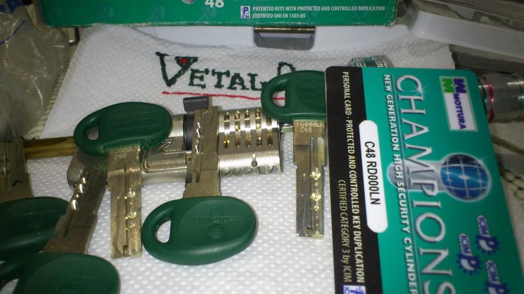

Re: Mottura Champions C48 Cutaway

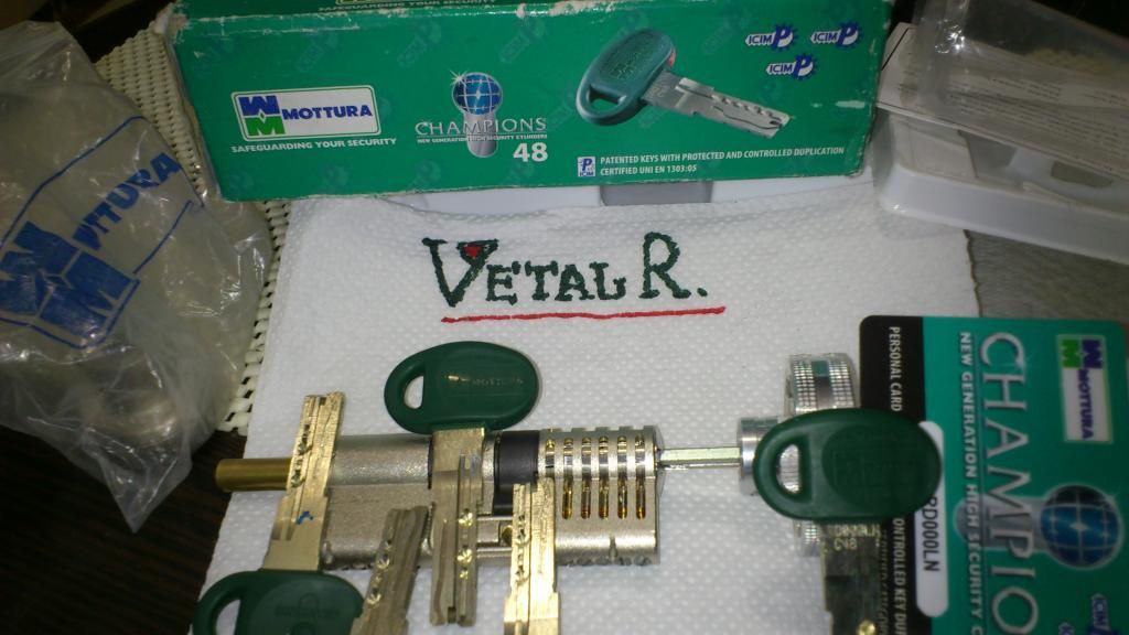

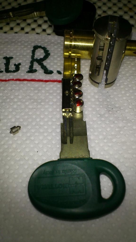

Postby Vetal » 25 Sep 2014 10:08
Image Image Image

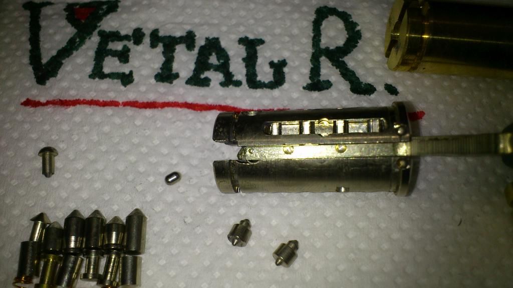

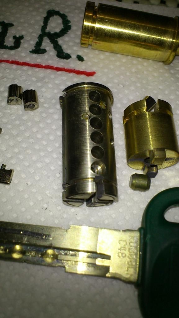

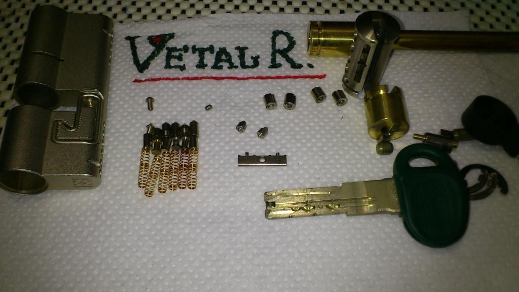

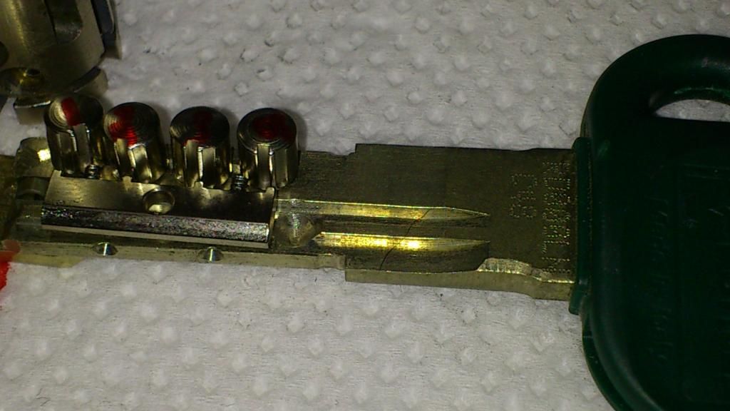

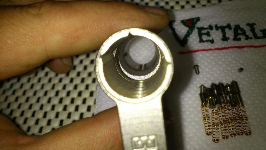

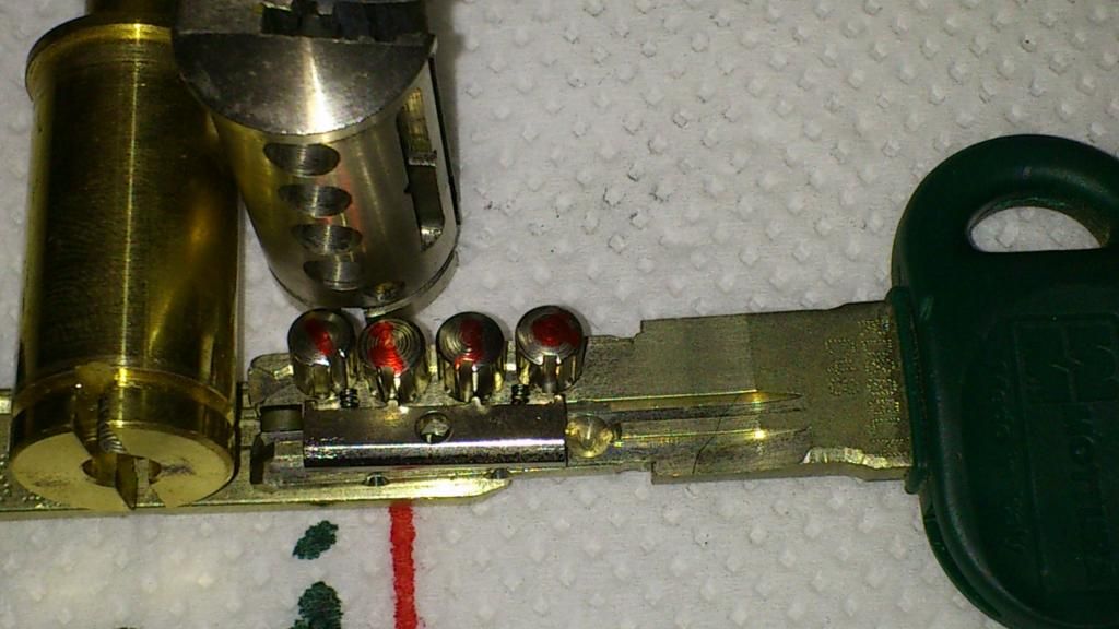

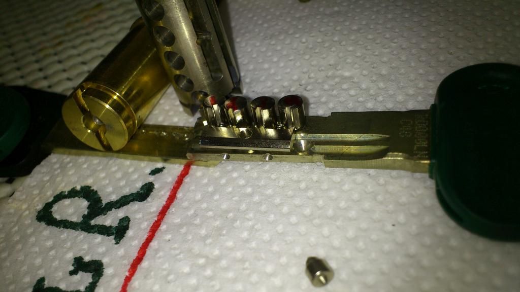

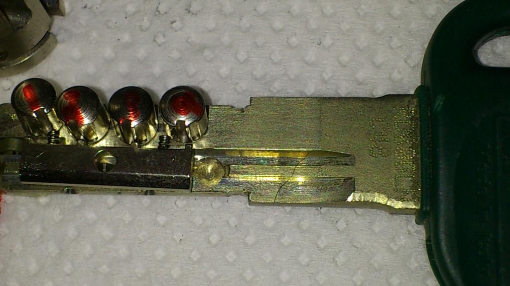

Postby Vetal » 25 Sep 2014 10:12
Image Image Image Image Image Image

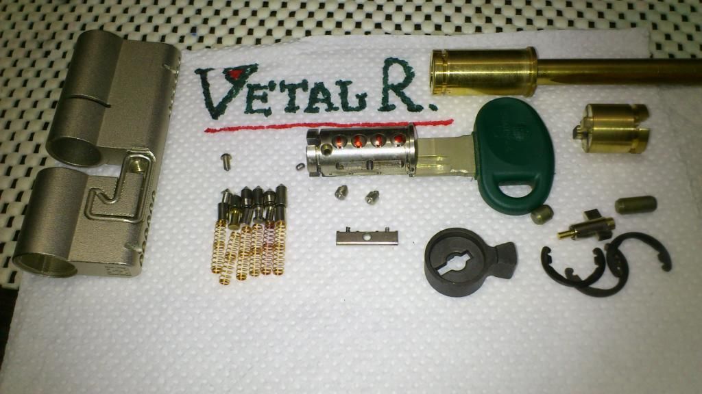

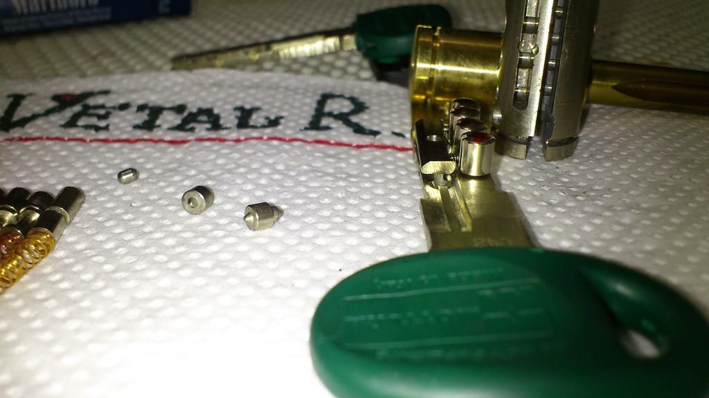

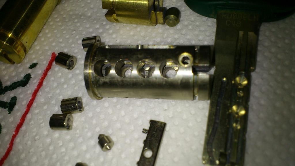

Postby Vetal » 25 Sep 2014 10:17
Image Image Image Image Image Image Image Image Image Image

Postby GWiens2001 » 25 Sep 2014 10:20
Wow! Just wow!
Now yet another lock that has to be added to my collection.
Guess the Medeco patent for rotational pins with grooves in the side for a sidebar is expired, but this is the first lock I have seen using the technology.
Thank you for sharing!

Postby Vetal » 25 Sep 2014 10:35
I was looking for this castle and came today. The castle is very well made​​, has not yet opened.
