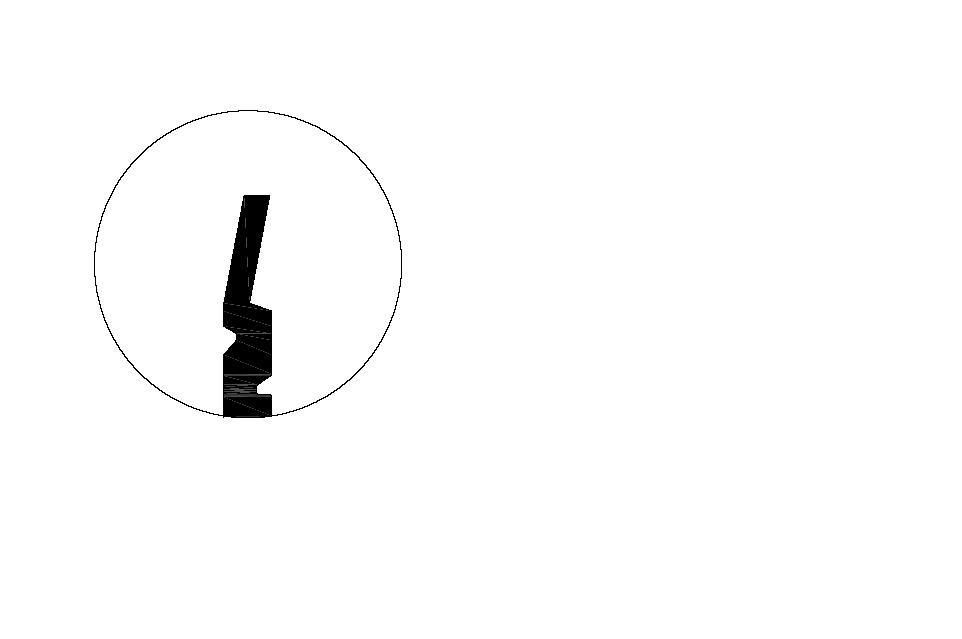

Does this look like the keyway you are working with?
http://img.photobucket.com/albums/v375/ ... corbin.jpg
Yea, looks very similar. In fact, here's a picture of the corbin lock (in it's locked state) and key I'm working with:
Sorry to hijak your thread Tozzy but I think you got the info you needed above. Good luck with it mate
Hey no problem ;). Feel free to add your own experiences to the thread :).
Besides security pins, you might also have a difficult pin arrangement.
Well to be honest, I was thinking that perhaps it is a difficult arrangement due to the fact that the 3rd pin sets exceptionally higher than the rest of the pins. And notice how low down the 4th pin has to be for it to set? :shock: Quite a tough cookie :x :P. In fact, so tough that it snapped my snake rake. £4.00 down the drain :cry:.
