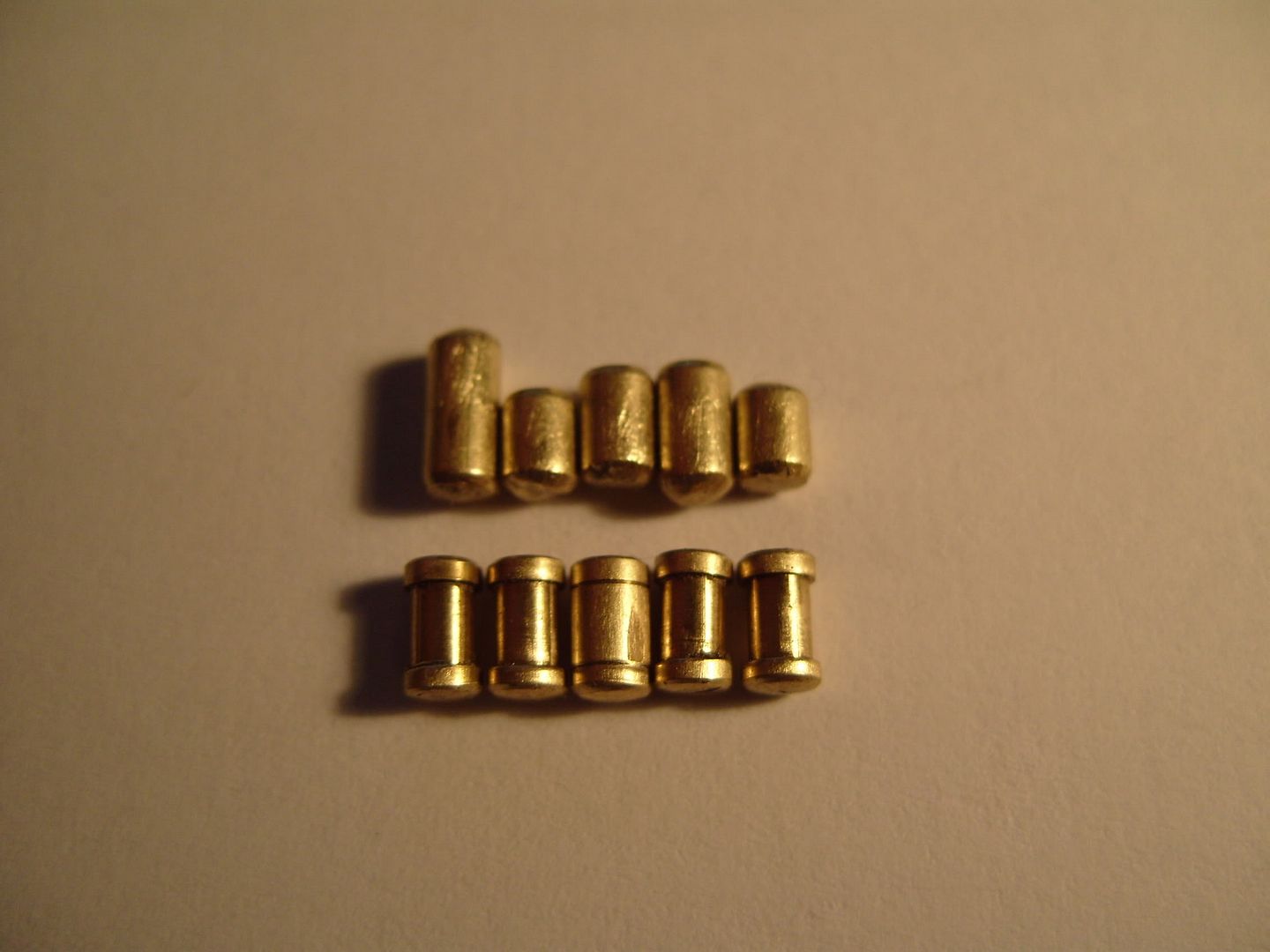

I know this is an old thread but I recently took apart a 65/50 and I took a picture of the pins.
For those of you that thought it would be one or two spools I got a surprise for you...
http://i127.photobucket.com/albums/p136 ... llpins.jpg
and yes I know the picture is upside down :oops:
