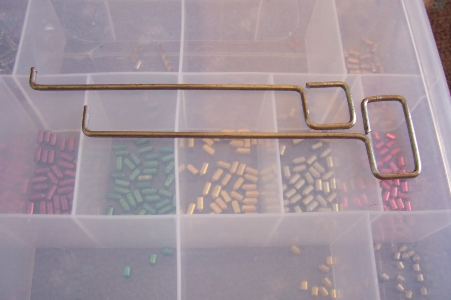

here's some similar wires to what i used..they are about 1.5 mm thick.
they look rusty but they are shiny and smooth..camera angle and light affected this.
