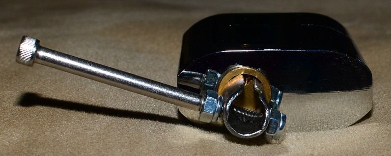

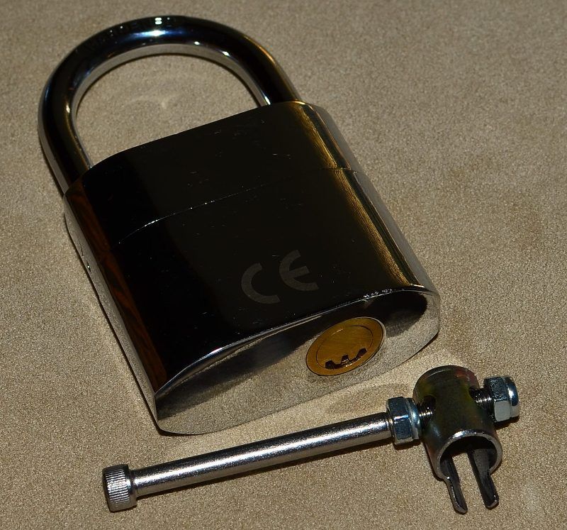

Today I made a well working tensioner for these kind of locks:
It´s made of steel tube and it provides tension in both directions. But still having trouble with this lock, mainly due to this false set I mentioned:
This tensioner was made for using bogota but it seems that it needs to be SPP´d so I have to expand the slot in the center of the tensioner...

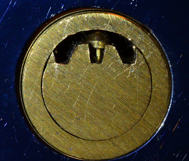

I had to dig through my padlocks to look for the ones I have with this keyway, I found three.
The first one is a pin tumbler without a sidebar. This is an old picture but I SPPed it and I guess it has no spools, just standard pins.
The second one, the one that started this thread, was a bit more difficult than the baogu padlock up here, but it's a pin tumbler without a sidebar and may have one or two security pins or not. I SPPed it a few times and am still not sure about it.
The third one is the padlock with siren I got from dx. It has a sidebar and some, if not all, spools. After I picked it I can no longer move the pins, so it definitely has a sidebar. Looking in the keyway I can see a spool like the one you have in your padlock.

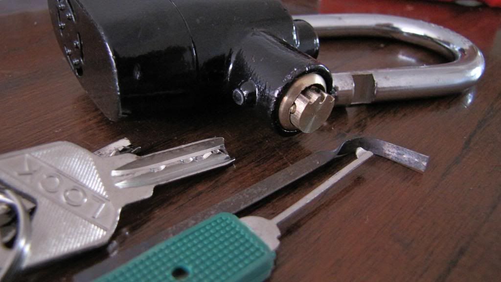

I got my lock from Hong Kong today! Really cool lock, everyone liked it when I demonstrated the alarm... :shock: I got it picked on my lunch break. I made a tension wrench out of a paper clip type of thing and it actually worked pretty darn well. Not as cool as Zeepia's , but it did the trick! It seems to have at least a few spools in it and has a sidebar. Here are some pics for anyone interested:
http://s1358.photobucket.com/user/Natha ... sort=3&o=0
http://s1358.photobucket.com/user/Natha ... sort=3&o=1
http://s1358.photobucket.com/user/Natha ... sort=3&o=2
I really like this lock because of its unique keyway. I'm glad I found this thread and to all the people who added to it. Thanks all!

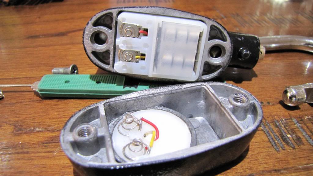

I think the following pics were too big to post ther so heres the links.
First one is the picked lock and the tools I used, the second is what's inside the base of the lock.
http://i1313.photobucket.com/albums/t55 ... 2472d9.jpg
http://i1313.photobucket.com/albums/t55 ... 132cd9.jpg
It must have spool pins judging by the action and it looks like it may have a sidebar. I think I'll pull the cylinder apart in the next few days and see what makes it tick. I'll post some pics when I do.
I took the base off the lock to see if the battery could be replaced. 6 button batteries inside would probably cost more than the padlock was to buy. Also It would be no good around moisture as there is no real waterproofing seals, but still a cool lock.

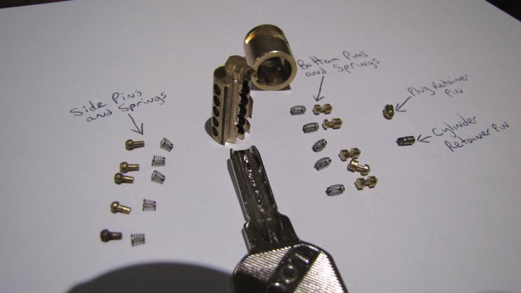

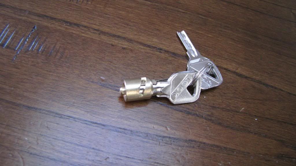

Well I couldn't wait, typical me.
Heres three more pics of the inside.
Again a touch too big to post on this page.
First the Barrel removed
http://i1313.photobucket.com/albums/t55 ... c0a153.jpg
Then two more of the exploded View
http://i1313.photobucket.com/albums/t55 ... 1a252f.jpg
http://i1313.photobucket.com/albums/t55 ... 7be94d.jpg
It shows there are individual side pins that act like a sidebar.
Line the bottom pins up and that allows the side pins go into the slots in the bottom pins to then turn the key.
I guess that when the keyway is picked to 20 degrees or so that most of the side pins were in the correct position with only one or two to go.

Quickpicknpay, I liked the inside pictures so much I downloaded them! I hope you can reassemble the padlock...
So that's why it was possible to pick it, it has individual side pins instead of a solid sidebar. I still miss that one in my collection, if it exist :twisted:

Nice pictures Quickpicknpay, weird to see that on the same day I got mine and picked it! :lol: I got that same rotation thing you were talking about, and also thought they were spools. Really cool to see the inside, now I don't need to rip mine apart, thanks! It is a unique twist on a sidebar idea. Fun to pick.
