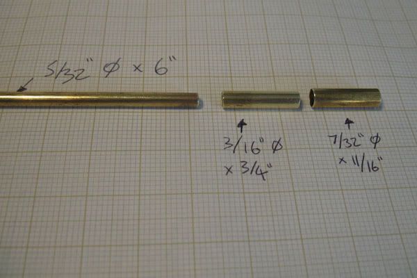

Cut the materials as listed in the photos, none of the measurements are critical though, the diameters are fixed but you can vary the lengths to suit.
The main (primary) shaft.
Cut a 6” length of 5/32” dia. rod

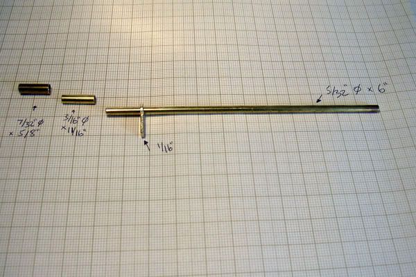

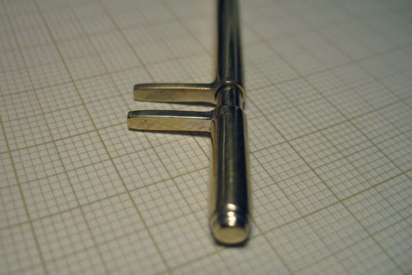

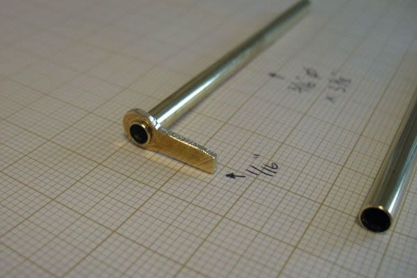

The tang.
Drill a 5/32” dia. hole in a small piece of the flat brass and with hole aligned and held flush behind the keyway, the outline of the keyway can then be transferred to this with a scriber.
Saw and file the piece to roughly the right shape. Final shaping will be done after the silver soldering process.
Cut the two collars from 3/16” tube and 7/32” tube, slide an off cut of rod/tube or a combination of both into the tube to prevent it from collapsing when held in the vice.
Deburr all pieces.

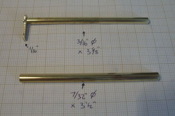

The outer (secondary) shaft.

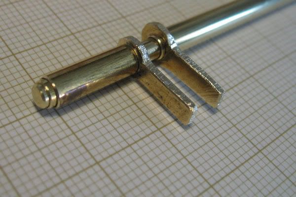

The two pieces of tube are telescoped together to provide a greater wall thickness and hence more strength. The inner tube passes through the tang while the outer tube butts up to it.
The tang.
The tang for the outer assembly is as described above, but with a 3/16” dia. hole instead of 1/8” dia.
Deburr all pieces.

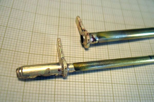

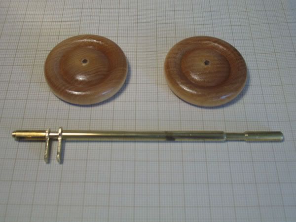

The tang end of the two shafts, assembled, deburred and degreased.
The inner and outer shafts are silver soldered as two separate assemblies.
The outside dia. was reduced slightly (with files) to approx 5g / 5.30mm to fit the lock, final measurements of the tangs and are obtained from the lock and levers.
The thickness of the tangs may need reducing depending on the levers.

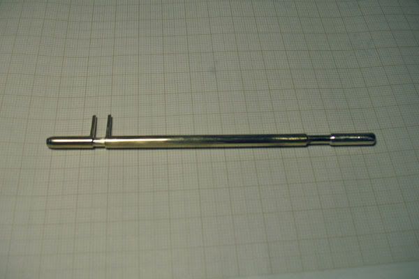

After a clean and polish, looking good!
The handle end of the inner shaft
The two pieces of tube are silver soldered to the end of the inner shaft. This serves two purposes, firstly to stop the outer shaft from sliding off the end, and secondly to provide a base for the attachment of one of the wheels.
The metalwork completed, the positions where the wheels (handles) will go, has been roughened and degreased to help the adhesive make a good bond.

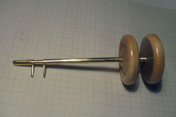

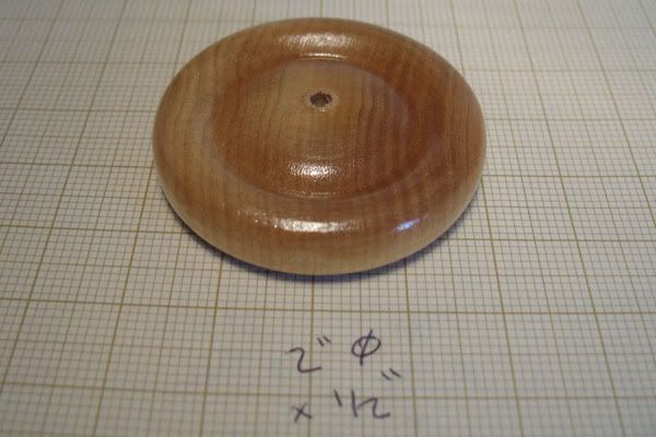

Wheels
They were given two coats of sealer and two coats of lacquer. A hole of 7/23” was drilled in each and they were attached with epoxy glue.
When the glue is set (24 hours) if you can wait that long, it’s time to put it to the test.
As they say “It does what it says on the tin”.
Very satisfying opening a lock with a home made tool, it took me longer to write this than to make the tool.

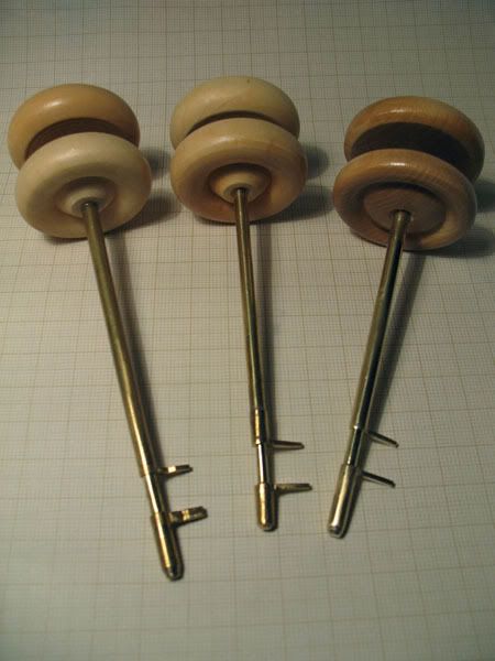

Left to right, LH 5g wavy keyhole, Universal 5g plain keyhole, Universal 5g plain keyhole made for this article.
