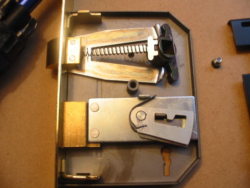

Postby NIC » 14 Apr 2007 12:35
Yes it is a very cheap lock. And like whiteknight said, pretty primitive.But hey that's what i could find here. By the way it's a 2 lever. Now who is going to send me a real one from England??

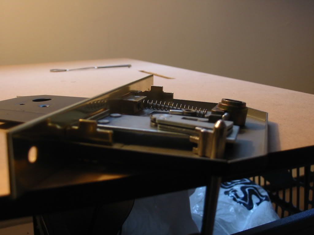

Postby NIC » 14 Apr 2007 14:48
I've been looking at the lock and i don't see how i could pick it with a simple wire!!??Because i would have to put tension on the bolt thrower and then pick the two levers!!humm ?? :roll:
