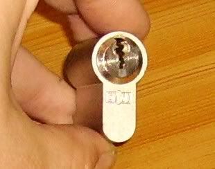

Can you post a pic of the front of the keyway ?

Postby Kaellman » 30 Apr 2007 4:50
Secure lock in a nut-shell. And some pics of the keyway would be nice :) Thanks for the post!

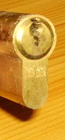

Anyways a few pics of the standard GEGE (restricted) keyway.
The snapped half i have.
Front of a rare brass gege, after 3000 changes this cropped up.
