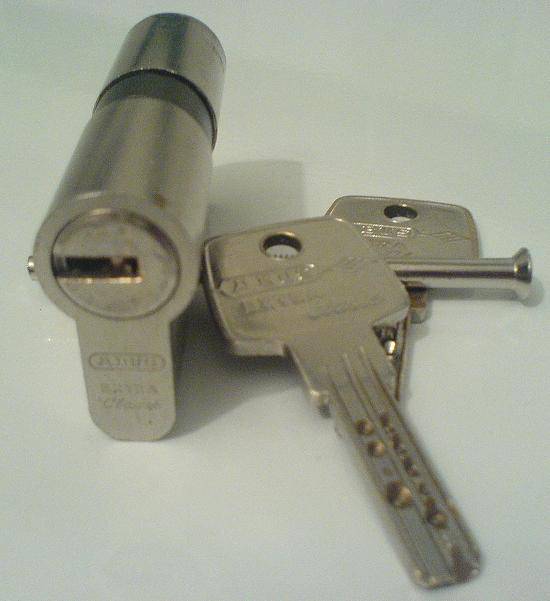

Postby zikmik » 3 Jan 2008 5:32
Hi,
I have trouble with picking ABUS EC 850/750
it is almoust the same as CISA Astral
I nead advice about what pick to choose and how to pick
Thanks in advance!

the best ive managed so far was 3 or 4 pins set/false set. i was using a bent long southord hook wrapped in electrical tape and reinforced with another pick cut down and glued on the back then wrapped tightly.
the drivers are like spools on crack. some are like negative spools, some are like negative spools with the center milled out. and the inverted spool ends are varying lengths.
Good luck.
John
PS as i have one in bits if i can get a digi cam ill take some pictures.

Postby zikmik » 8 Jan 2008 6:24
I bought it for 3€ on junk market, salesmen obviously didn`t know what he selling!
Other used standard European profile cylinders coast 5€ :)
I find here
http://www.sicherheitsladen.net/Tuersic ... r::19.html
that brand new coast 26.55€
Can one of these do the job?

Postby zikmik » 9 Jan 2008 8:51
roadmaster wrote:8) Hi Zikmik, that are very nice picks ! Did you make them yourself ?...
Unfortunately no, I find these picks on net and I wonder is these the right tools because abus and cisa have pins on bouth sides.

Postby JackNco » 9 Jan 2008 13:01
don't worry about the pins on the opposite side to the bible. they are what are known as passive pins. ignore then they don't need to be picked. concentrate on the 6 pins mounted at the bottom.

Postby zikmik » 10 Jan 2008 2:51
JackNco wrote:don't worry about the pins on the opposite side to the bible. they are what are known as passive pins...
Thanks for the tip, also thanks to raimundo.
I watch Carl_Mor 6929 videos and he mostly use snake pick. I try with my snake pick from SouthOrd JPXS-6 Jackknife but no luck.
I will keep trying and concentrate on bottom ones...

Postby bluestar » 25 Jan 2008 3:58
Sorry to correct you JackNco, but the Pins on the upper side are active. We're actually talking about two different locks here, although they have the same face.
The original post shows the Abus EC750/EC850/Cisa Astral, which ist exactly the same lock sold under different brandings. To pick them, I use a standard snake pick inserted sideways (using SPP, not raking, of course).
Zikmik has a rare model, an old EC700/EC800. These were the predecessors of the EC750/850 and their upper pins are active. You can tell the difference by looking at the plug, which is smaller in the EC700, and at the "upper dimples" (the four) on the key, which vary in depth.
So, youre ut to a funny 10-pin experience, zikmik :)
Oh, and your rake picks will only fit with a lot of luck - I haven't encoutered an EC750 which could be opened by raking yet. EC700 are even harder. So I'm afraid you have to rely on SPP.
