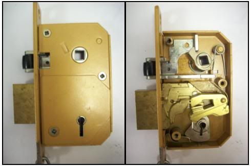

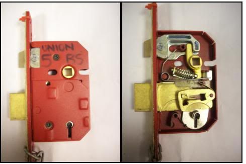

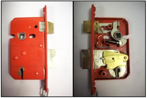

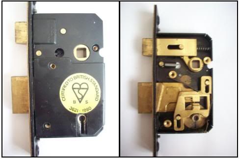

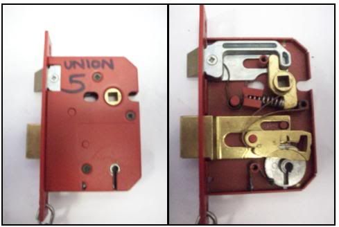

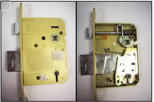

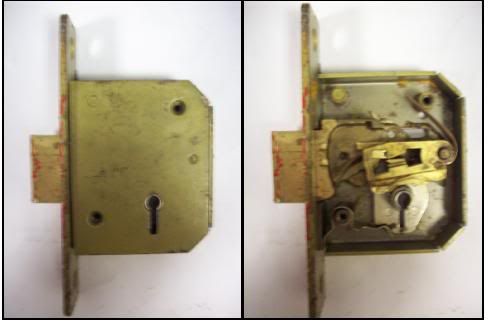

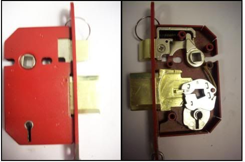

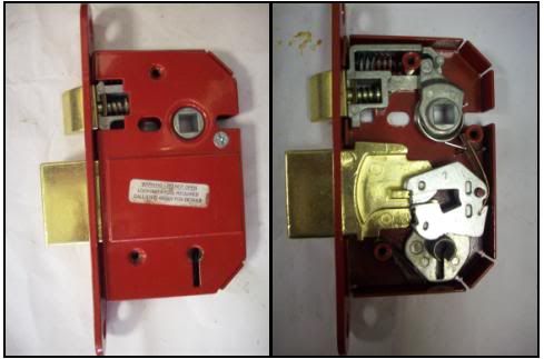

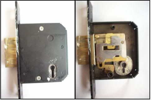

thought id transfer some pics from my home made lock bible for your reference. All pics are my own nothing copied (you can tell by the poor quality)
Not all at once they take a while to copy and paste but heres some to start the thread off:
Union 5 lever non BS red
Union 5 lever BS red
Union strongbolt BS
Abus Red (comes in black form renamed York BS)
Belguard 5 lever (also known as gibbons)
Old Era fortress BS
Chubb 3k277 7 lever BS

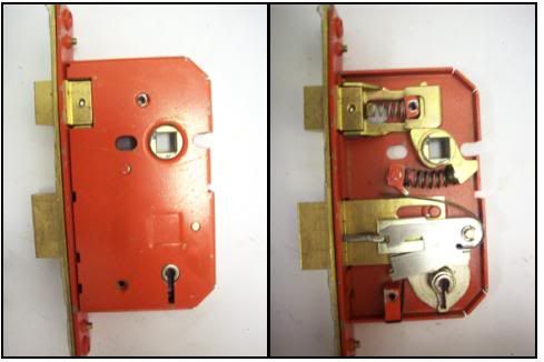

Postby Rickthepick » 26 May 2010 2:55

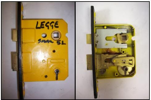

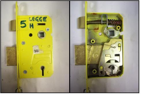

Era Profit
Merchant
Yellow legge old BS
Yellow legge non BS
Asec (same as legge BS black)
Chubb 3g115 non BS

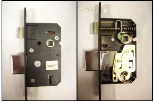

Postby Rickthepick » 26 May 2010 3:04

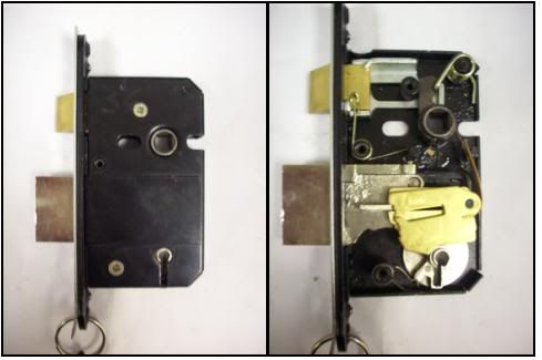

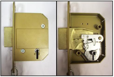

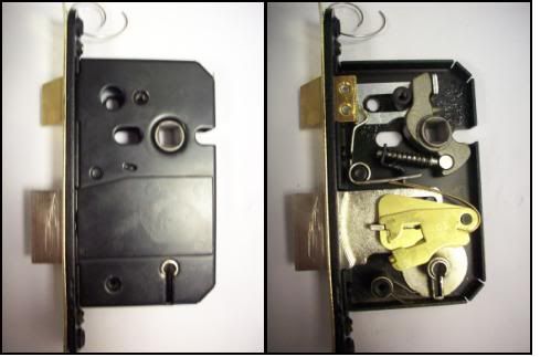

York BS black (same as abus red)
Walsall detainer BS
Santos (also known as Henderson) *Levers move around fixed stump*
Old BS legge black
New BS legge (same as asec gold)

Hi Rickthepick, thanks for all the pics!
I dont know anything about British Standard but I noticed for the most part that the locks you listed as BS have a metal plate with the shape of the letter H cut into them and they look like they ride up and down. Can you explain its purpose or explain what are the requirements for a lock to be certified BS?
Thank You,
Re: uk lever locks - lots of + pics
Postby Rickthepick » 26 May 2010 8:30
cant get better pics most these locks are gone now, i never intended to show anyone else more for my own reference.
Bs locks now require: anti-drill plate, 2 inch bolt throw, anti saw bolt and general strength against brute attacks.
you will notice non bs ones have smaller bolts, non, or non-hardplate protection plates.
il get the rest posted soon. :mrgreen:
Rickthepick
Posts: 1613
Joined: 24 Sep 2009 4:15
Location: Wolverhampton
Postby Phatphish » 26 May 2010 8:52
squelchtone wrote:Hi Rickthepick, thanks for all the pics!
Thank You,
Those plates are actually the levers Squelch. Instead of pivoting about a fulcrum they slide up and down.
Specification BS3621 was launched in the 1960’s to regulate security on domestic and commercial property. Many of the requirements still stand today having revised the BS3621 standard in 2004 to bring the specification up to date which included a change in bolt length from 14mm to 20mm.
BS3621: an insurance standard for locks, specifying, for example, the minimum number of differs,minimum 5 levers and that there is protection against drilling and sawing, and that the strike box is metal (equivalent to the European standard EN12209)
Postby Rickthepick » 26 May 2010 16:02
i decided to make my own as thought it would be a good exercise to get to know the locks... and it was
Its also good to know how some locks work; the henderson/santos for example, where the lever pack is riveted to the bolt and moves around a fixed stump. It would be confusing if you didnt know that and were trying to lever pick it
