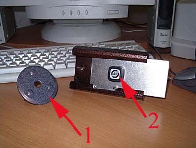

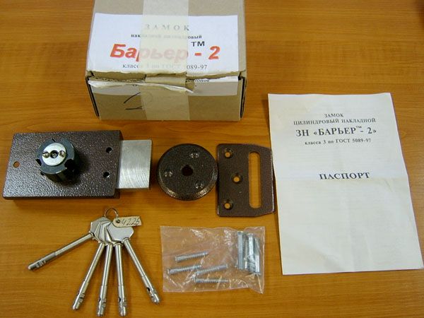

Postby kerti » 23 Jul 2013 10:06

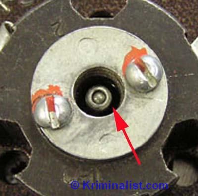

Russian lock series Barrier. That is Barrier 2
Backside view. Bolt is removed.

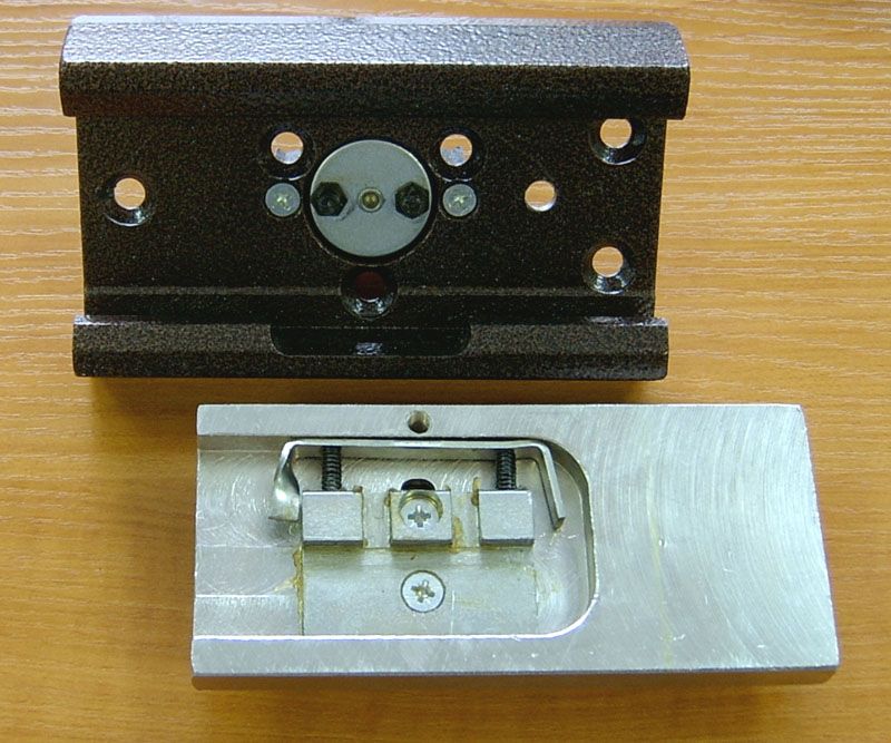

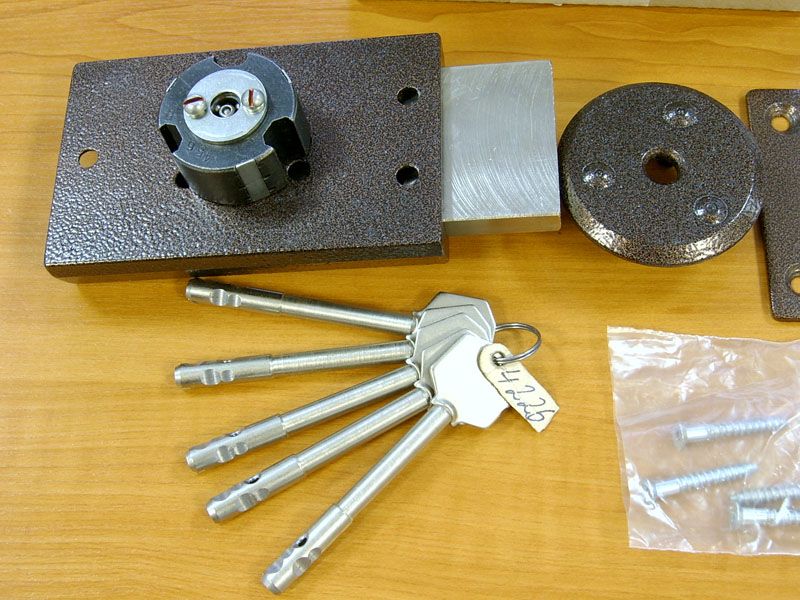

Postby kerti » 23 Jul 2013 10:14

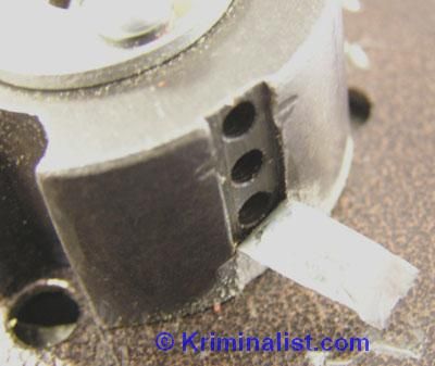

Barrier 2
And that is Barrier 2M
Lock "cylinder"

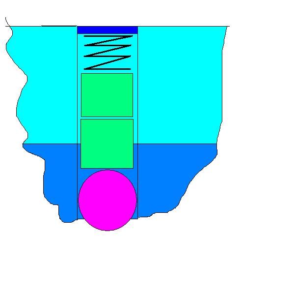

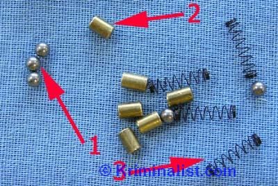

There are three groups of pin chanels. Each group has three pin chanels.
Each chanel has spring, two pins and ball bearing.

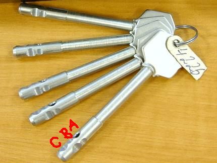

Does the hole in the key above the two bitting cuts have anything to do with how the cylinder is driven (turned)?

GWiens2001 wrote:Does the hole in the key above the two bitting cuts have anything to do with how the cylinder is driven (turned)?
I think you mean the hole in the A-position? This hole is zero(lowest) depth key cut. B is first depth, C -second. No cut-4th depth

GWiens2001 wrote:how the cylinder is driven (turned)?
The key engages with cylinder with rectangular cut to turn cylinder clockwise or contrclockwise.
And this is one from a few differences between Gerda and Barrier.
N.B. The keys at that pictures are for Barrier 4! That is why these keys have other key cut structure.

Pin chanel inside
Ball bearing also makes problem for picking and blocks possibility of bumping. I think the decoding will work for that lock only. :) John Falle style instrument.

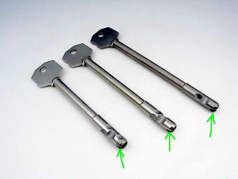

Postby kerti » 28 Jul 2013 10:25
Barrier 4
Bolt removed
Side view
Barrier 4 has new key cutting system. Pin chanels have random position into cylinder space.(may be manufacturer lie :mrgreen: )
