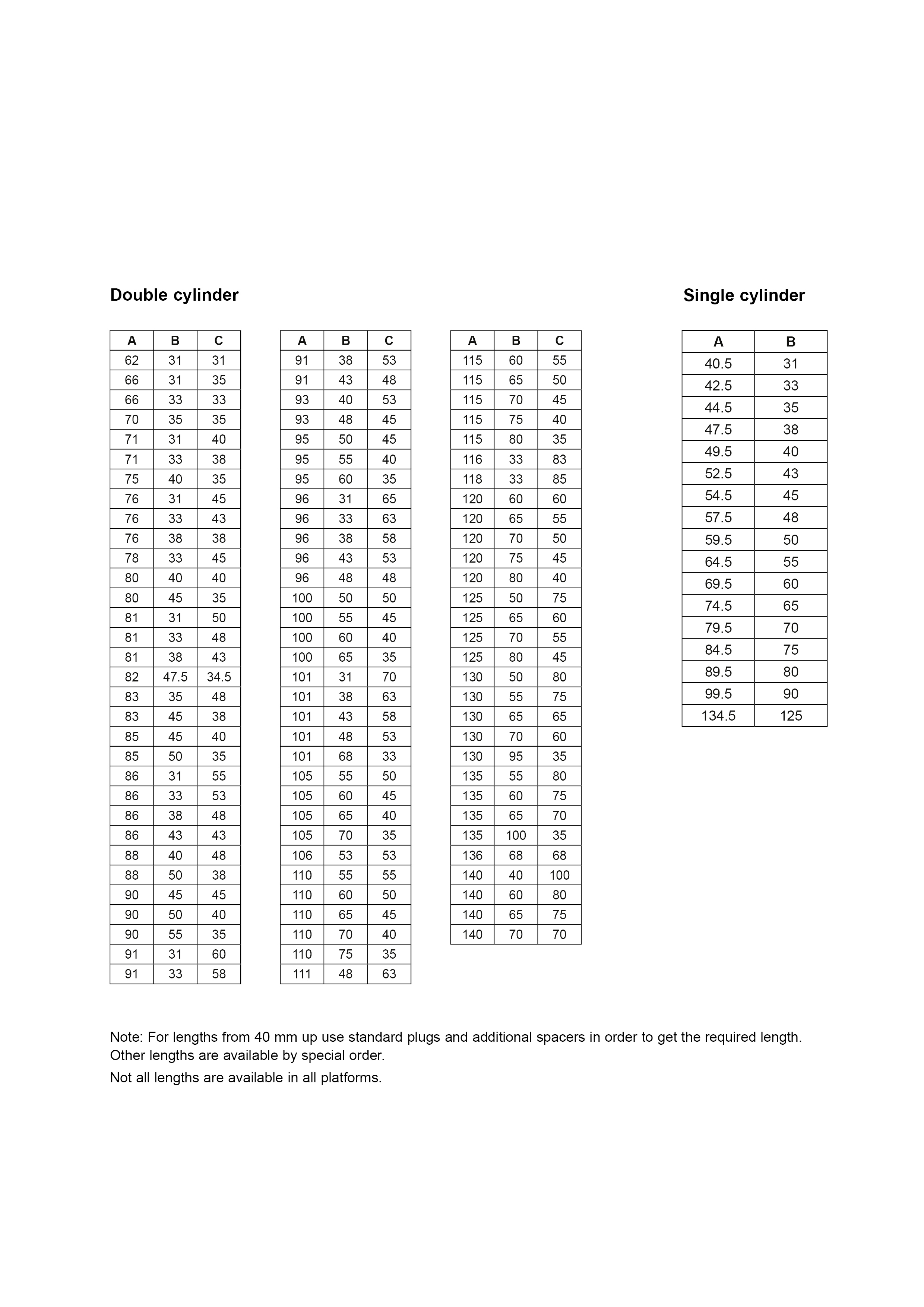

i need to find a Mul-t-lock core, 30mm deep euro profile, I've searched high and low and the only thing i found so far is bosnianbills rotalok video in which he uses that size core, but doesn't give any specs. is that a euro half core? sorry I'm not sure what its called thats why my search is proving futile

The half cylinder sizes for Mul-T-Lock start at 40.5mm overall length (A), and 31.0mm distance from face of door to center of retaining screw (B) as shown here:
http://mpc.mult.production.assaabloy.co ... =2091&dl=1

the multlock core would go into a rotalok padlock that came with a standard key, i am hoping to make it a bit more secure, I'm not sure what those distances mean but i know the lock takes one half euro cylinder

Buy a single cylinder in modular design http://multlock.com.ar/English_Product_ ... ers/c2.pdf
The 30 mm size usually has approx. 25 mm long body plus approx. 5 mm plug end standing out.

... or you can buy a fixed (not modular) design and cut the unnecessary part of the body with saw (as seen in the Bosnianbill's video - GEGE cylinder).
