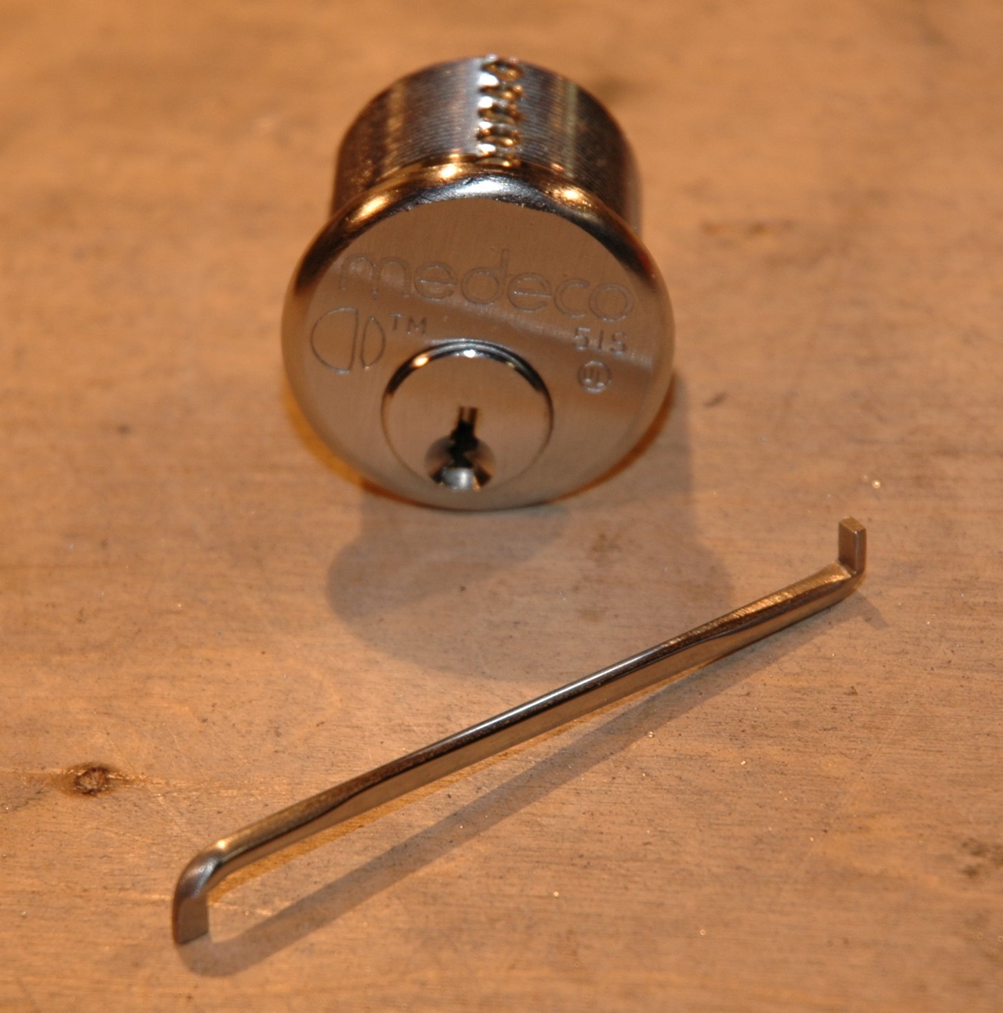

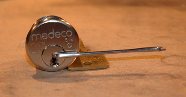

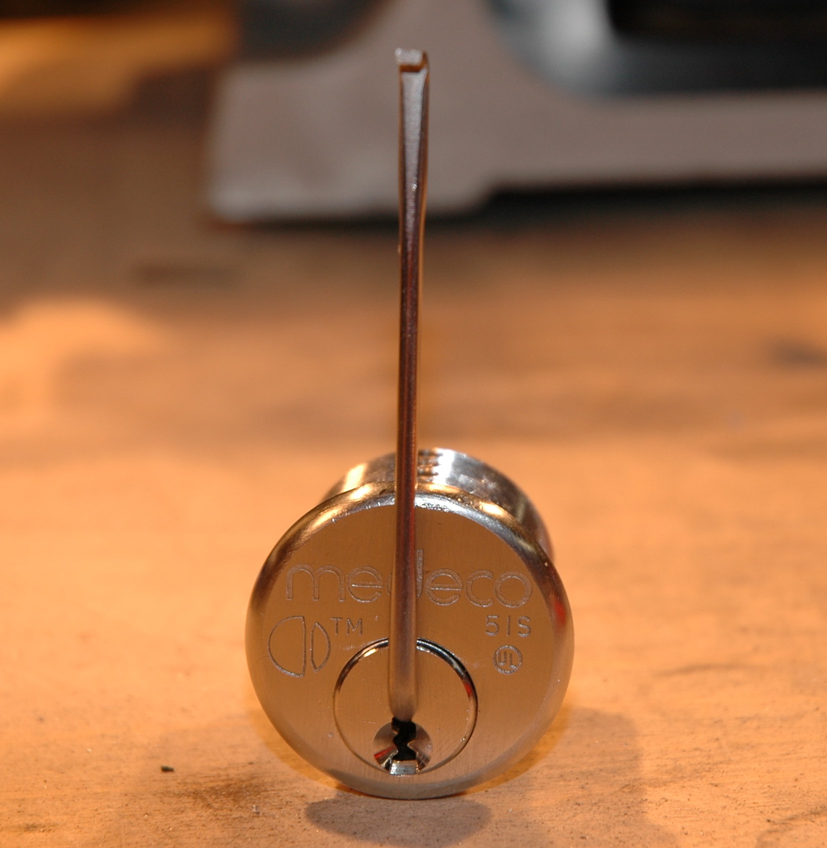

I'm strongly of the opinion that the tension tool is often as important as the pick. Lately I've been making more and more top-tension tools, and wanted to share my latest creation. The source material was 1/8" steel rod. Usually I use 3/32", but decided to try something new. The wrench is designed so it fits extremely snugly into the top of a Medeco lock, and can be used either vertically or horizontally. The larger stock gives more contact at the face of the lock, making the fit more secure. All work was done with hand files except for cutting the steel, which was done with a cutoff wheel. The polish was obtained by working up to 2000 grit sandpaper and 000# steel wool. As you can see, the tool fits snugly enough to stay in place without being held.  (all images clickable)
