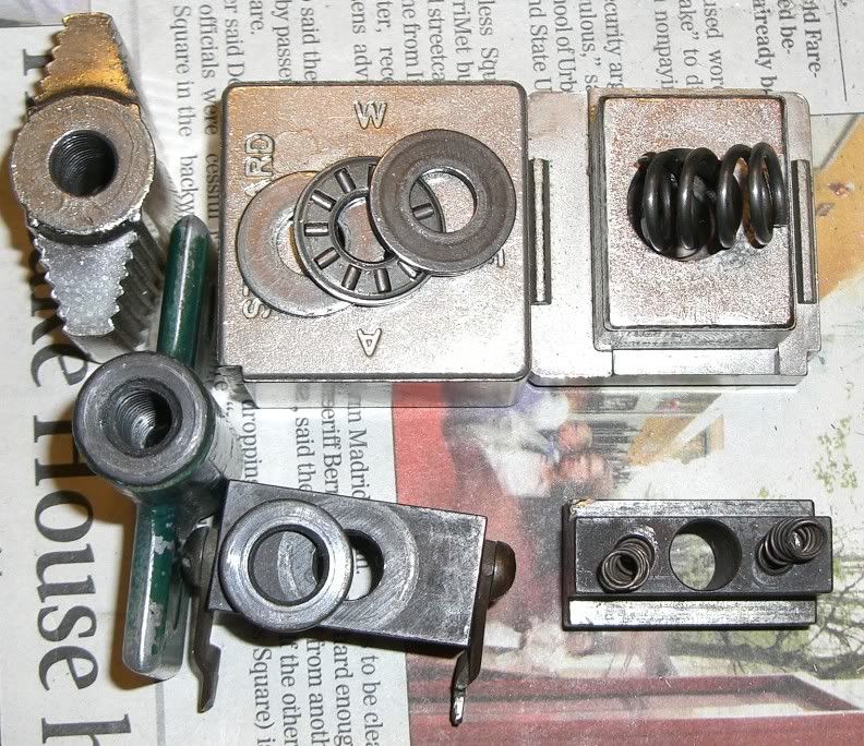

Postby WOT » 26 Apr 2008 23:34
I'm sure I'm the last one to discover this, but the Framon #1/2 accepts standard HPC & Ilco cutters, so sourcing cutters isn't too bad, but as a hobbyist, it's very hard to find small parts.
The vise grip springs are very frail and they don't come by very easily.

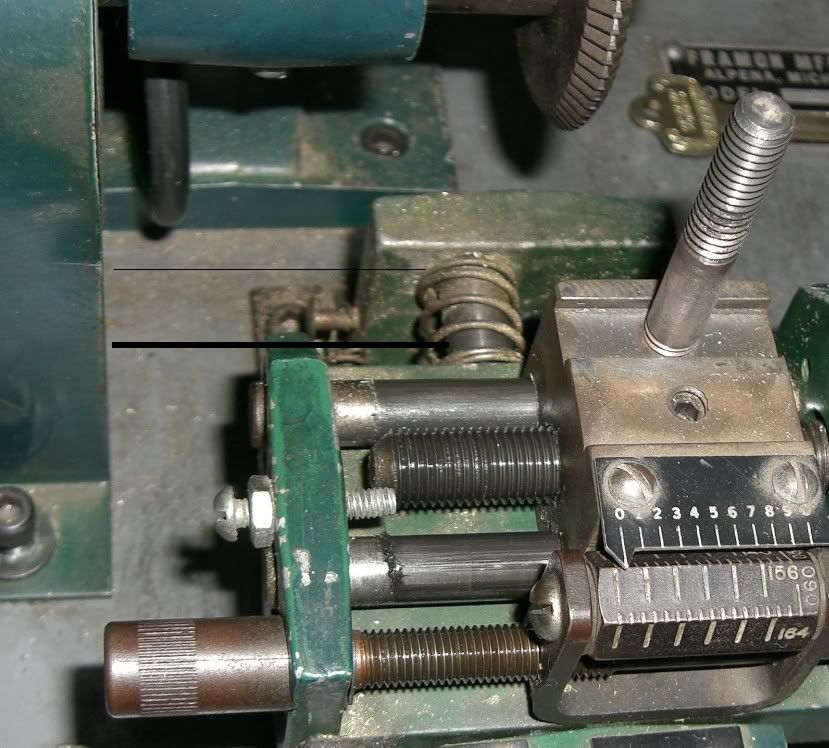

Postby WOT » 28 Apr 2008 2:20
Click each image for full size.
I'm not sure how sturdy the HPC's vise is, but the vise on the Framon is rather wimply made compared to an Ilco duplicator.
A small pressure you can apply with one finger along the black line flex the chassis enough to cause the cutter to cut deeper, so if its sitting on an uneven surface, the calibration might be affected.

Postby itisjustme1 » 22 Jun 2008 5:53
WOT,
It looks like the same vintage F1 I bought 10 years ago and it dates back to the 70's but it isi still a great machine that works very well for me.
I have not experienced the problem you have when applying pressure on the area you have lined in black.
I did buy the D&D manual from Framon and in the manual it tell you the main bearing should not be lubricated and if you want a copy of the manual let me know because the first section has all the care and setup in it.
If your F1 need this much attention I would without doubt send it back to Framon and for $80-$120 it will come back better tnen new.
I am thinking about sending mine back and have it gone over and then converted into a F2 for higher security keys. (if they are still offering the F2 conversion.
