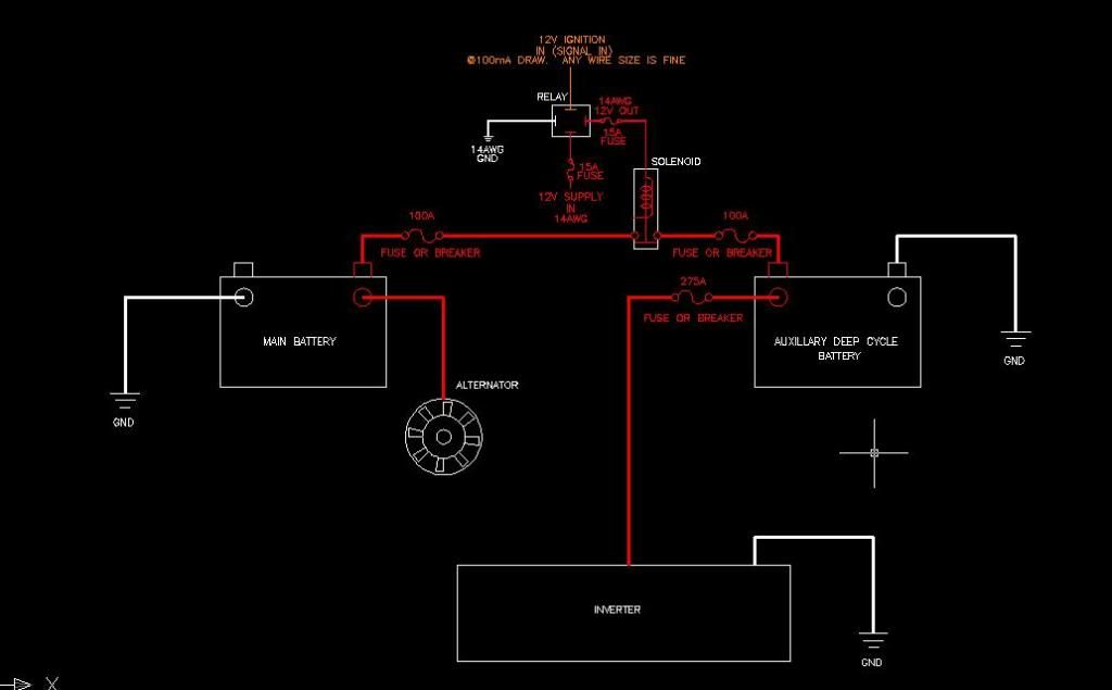

I second the redi line inverters. They are pretty dang good. Also, be sure you calculate your 12v cable size according to the length of run and the amperage draw of the inverter. Install a second battery preferably a good deep cycle and isolate it from the vehicle battery. A heavy duty solenoid and relay should be used and configured so that when the van is running the secondary battery is taking charge but when the engine is off the second battery is isolated from the main battery because the solenoid is not engaged. This will prevent you from running down the vehicle battery with heavy loads. At max load with 90% efficiency a 3000 watt inverter can pull 275 amps so you will need heavy enough cable from the secondary battery to the inverter for that load. The cables from the vehicle battery to the isolation solenoid to the secondary battery can be a smaller size but 4ga is about as low as I would go personally. It will help when you buy your second battery to buy a model with dual post configuration to make wiring a bit easier.

I should have mentioned just what you state 2octops. The ford solenoids just will not handle continuous use. I don't recall exactly where I came up with the one I have but I do recall that it is a 100 amp continuous duty solenoid which is about all your alternator is going to put out while the vehicle is running the fan, fuel pump, lights etc. It cost me about $100 iirc plus a few bucks for a relay. Wire from 12v "ignition on" to the relay 12v signal input. When your ignition is on the relay gets power and powers up the solenoid and you're charging. Turn the ignition off, the power is cut to the relay which kicks the solenoid out and your batteries are isolated from each other.
The easy solution is just to pick up the isolation unit from an RV dealer and in the end, the time it saves over sourcing parts etc yourself probably costs about the same. For some reason I just have to do things the hard way.

Altashot wrote:We use welding cables. I don't know the gauge, but it's about 5/8" thick. They never get hot.
M.
Depending on how close your auxillary battery is to your inverter you could be fine with lower gauge wire. For example if your inverter is less than 3' from your aux battery 4awg is fine for a 275 amp load. Up that to 9-10 feet though and you're looking at 0000awg. Chances are you will never see a full load situation on your inverter for very long but it's just good to size for capacity.
Also, don't forget you'll need either 3 high amperage wafer fuse blocks or 3 manual reset 12v breakers. Here is a generic diagram for an idea.

zeke79 wrote:I should have mentioned just what you state 2octops. The ford solenoids just will not handle continuous use. I don't recall exactly where I came up with the one I have but I do recall that it is a 100 amp continuous duty solenoid which is about all your alternator is going to put out while the vehicle is running the fan, fuel pump, lights etc. It cost me about $100 iirc plus a few bucks for a relay. Wire from 12v "ignition on" to the relay 12v signal input. When your ignition is on the relay gets power and powers up the solenoid and you're charging. Turn the ignition off, the power is cut to the relay which kicks the solenoid out and your batteries are isolated from each other.
Yeah, I have a little "river ShacK" that i have wired for 12 volts DC when we are not using the generator. I got the idea of a Ford started solenoid after I saw one on a motorhome... It smoked after a couple of minutes of glowing red. The continuous use solenoid can also be picked up at RV suppliers. The diesel truck that I have has two huge batteries (heavy,too... I just replaced both last spring). It is my plan to use the inverter only when the truck is running. I have a battery isolator that I purchased for my charter boat before i sold it.

It might not hurt though to check and compare costs of buying an aux battery (sealed, ventless) and putting it in the rear of the cab. It might actually work out to be less $$$ due to the fact you already have an isolator and could run 4awg from the front batteries to the aux battery instead of 0000awg to carry the load directly to the inverter over that long of a span. The length running from under the hood and directly to the inverter is just getting long which ups the required gauge of wire quickly. Heavy wire is expensive and 0000awg is just ridiculously tough to work with.
Each way has it's own pros and cons so go with what fits your needs the best.
