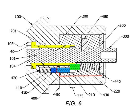

globallockytoo wrote:Farmerfreak,
Have you ever seen the Binary Plus system from Australia?
Haven't heard of it before. Thanks for the links. :D
Based on what I see in the brochure. I'm can't figure out what would make these difficult to pick. The driver pins are standard and aren't affected by the trap pin system. Which means you could pick it like normal. If you messed up and over set a pin you should be able to easily release it from the trap by pressing the side pin with your pick. ...But in the patent that MacGyver101 found. The trap pin system does affect the driver pins. And that would likely cause some serious picking issues.
MacGyver101 wrote:Somewhat related to this general idea, I ran across an interesting patent yesterday, for a tubular lock that uses spring-balanced pin-stacks as an anti-pick measure (Patent 7,685,854).
The idea is actually pretty interesting. Instead of acting on the pins directly, the key pushes against transfer bars (which I've coloured yellow in this copy of the patent diagram):
The transfer bars push against a series of internal drivers (green) which are heavily sprung. As the internal drivers (green) are depressed they allow the actual top/bottom pins (blue) to move towards the shear line (red). Because the "green" spring is much stronger than the "blue" spring, it would be extremely hard to determine whether or not the "blue" top/bottom pins are binding or properly set.
Very neat idea.

MacGyver101 that design is cool.
