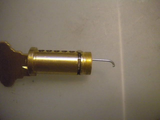

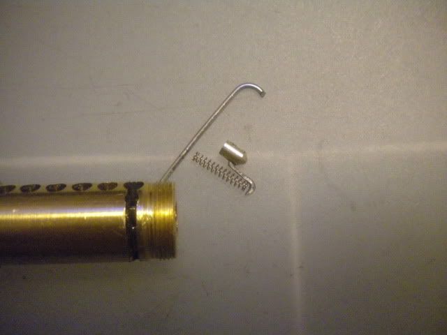

Postby FarmerFreak » 7 Jun 2010 20:18
The idea is to have constant spring tension on the bottom pins. I know what you're thinking, "What would that accomplish?" The answer: Probably not much, but it has the potential to play mind games with the picker!
This was a test run to see if I could pull it off. Which I did, and it could probably use some improvements. But here it is.
So how will this be able to play mind games with the picker? Simple, randomly add a couple of Master Bump Stop driver pins in a few chambers.
If you aren't familiar with Master Bump Stop pins. They don't drop down far enough to touch the shallower key pins in the resting position. So when someone is trying to pick this lock they will be able to clearly find the regular binding pins and set them. But when it comes time to set the Bump Stop style pins they will likely be left trying to figure out which pins those ones are.
In theory it shouldn't be too hard to figure out and pick a lock set up this way. Just remember exactly which pins you have set, when you can't find a binding pin any longer you would have to remember to push one of the previously non binding pins up until it makes contact with the driver pin and then lift it more to set it. I have a feeling that that may be easier said than done, ...which is why I'm going to test it.
It's an interesting concept, so I'm giving it a try.

Re: Spring loaded key pins
Postby MacGyver101 » 7 Jun 2010 20:43
That's just evil. I like it! :D
Postby FarmerFreak » 10 Jun 2010 7:44
Good questions Femurat.
I'm not too concerned about bumping since I plan on having at least two of the driver pins resting above the key pins (above as in not touching the key pins :wink: ). Although at this time I'm not planning on putting stiffer springs over those special drivers. It's a trade off, I don't want so much spring tension that it's a real pain to get the key in and out. But if I put stiffer springs above those pins, it'd be even more bump resistant.
As far as the overlifting attack. I don't know. I've never had much luck with overlifting in pin tumbler locks. But I've seen it done and this design should make it easier to do. That could be a real problem, and it's something that I will see if I can do when I'm finished. Of course if I can't do it, that doesn't mean that it can't be done. :|
