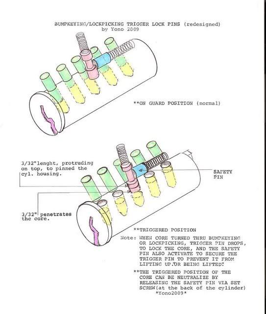

Postby yono » 23 Apr 2011 3:17
This design of mine is still in progress.. if i install another trigger pin on the other side, it seems that i covered against lockpicking, bumpkeying, and plugspinning. i did successfully done that on one side in a mortise lock cylinder. (i wish i can acquire a machine that can complete my project.)

Postby dls » 23 Apr 2011 13:34
Your safety pin idea is exactly the same as my idea for a relocker on the back pin which would be activated by overlifting or bumping but i dont think it would defeat plug spinning because it would see the plug the same way as the top pins in my opinion the safety pin needs to be in the plug and locking into a groove in the body.
the reason for a grove is to give it time to set. this groove could be shallow and have some pin holes in it too to lock it up propperly
