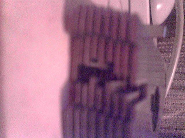

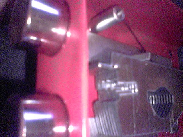

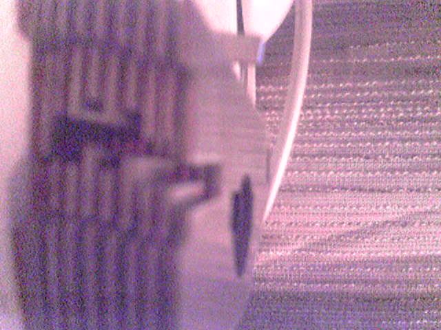

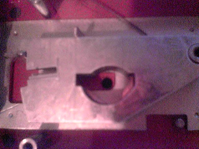

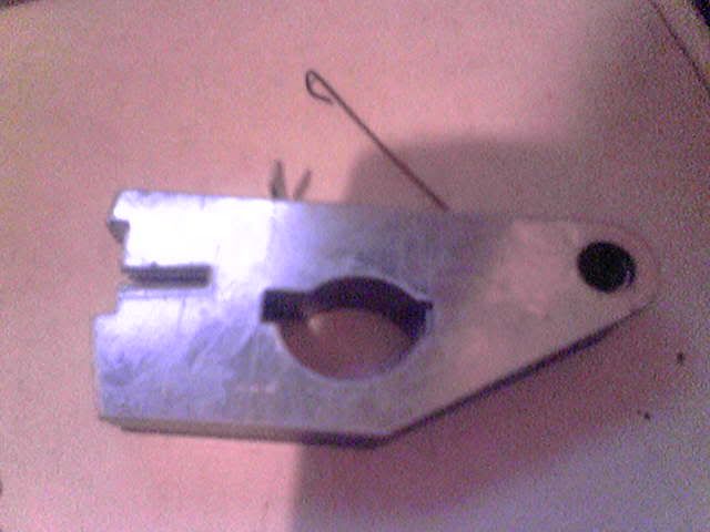

Postby master in training » 18 Feb 2005 21:56
I finally got the guts to strip down my safe to get a better view of it and try and make a pick for it, i have a simple southord set, so i'll need to make some curtain picks(? :? i think this is the name of them, i havent looked into it enough to make one yet!)
if anyone wants more info or anything, i'll do my best to help.
in response to my own question (sort of) the lock seems difficult to pick for myself, but anyone with a knowledge of these locks could probably have it open in a few seconds!
As with all my pics, sorry for the poor quality, i only have my phone for a camera.

Postby NKT » 19 Feb 2005 21:24
Ok, some tips:
The biggest issue is that the levers all move together. This is by design. Put a finger on the top lever, furthest from the spring, and push it upwards. See how you never know which others will move as well?
Try putting a little tension on with an Allen key or whatever. Now, the gates could be pushed up and down individually, but every time you push one, it will move the others.
Get each lever to bind in the gate, and you are sorted, and the bolt will throw.
Now try it without looking, when the lock is assembled!
