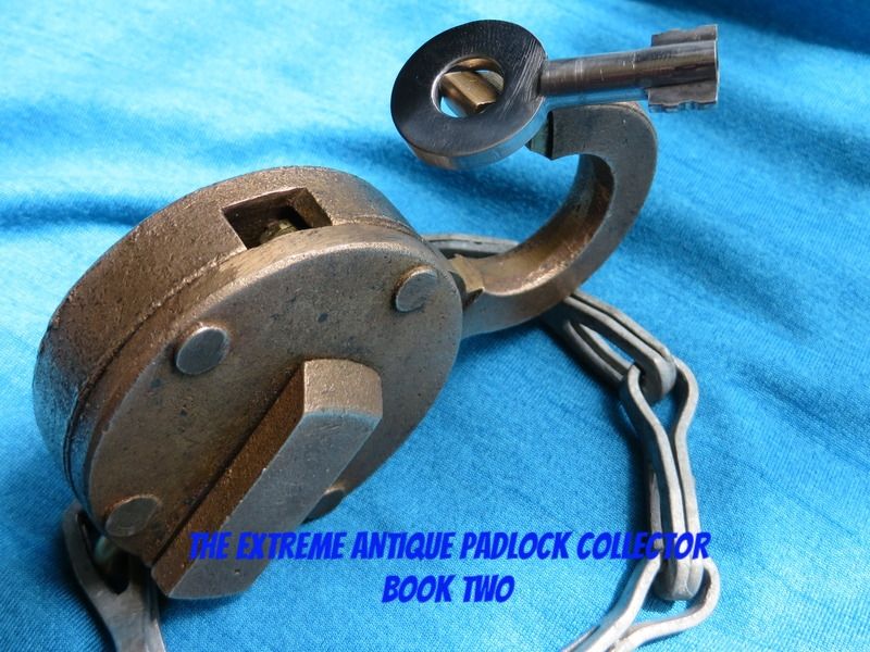

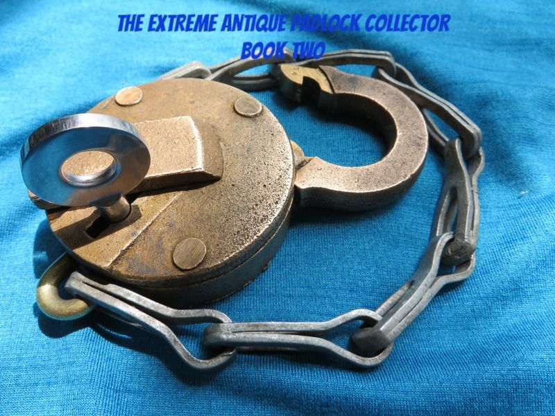

This very large AMES SWORD padlock was received without a key and in the closed position. Today, I machined a perfectly working key for this lock from solid cold rolled steel bar stock. The total bit width on the key was machined to .325 inch. This measurement is critical in order to avoid obstruction with a pair of raised lips that protrude from the inside of the top lock case cover. A similar pair of raised lips is located on the inside bottom of the lock case. These lips are sickle shaped and help center the tumbler stacks. The bit thickness was machined to .075 inch and the barrel hole was created with a #16 drill bit. A working key for these AMES SWORD padlock will work in either the clockwise or counterclockwise direction. Over cutting the bits will cause poor shackle movement and may not scissor the interlocking lever tumblers enough. Bit height is critical for these padlocks (to the nearest .005 inch). This padlock is stamped 70 on the shackle toe.

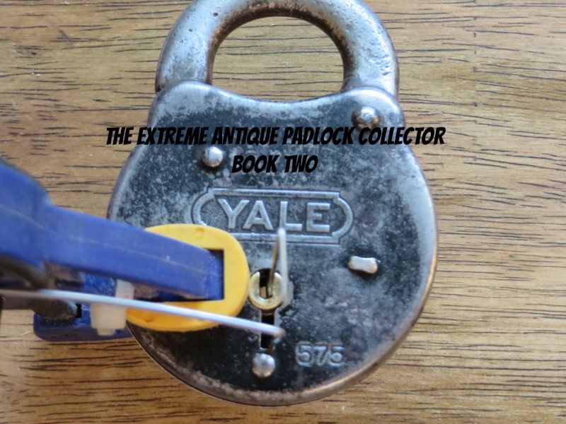

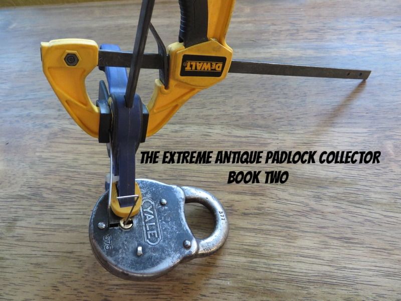

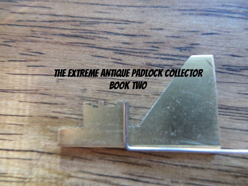

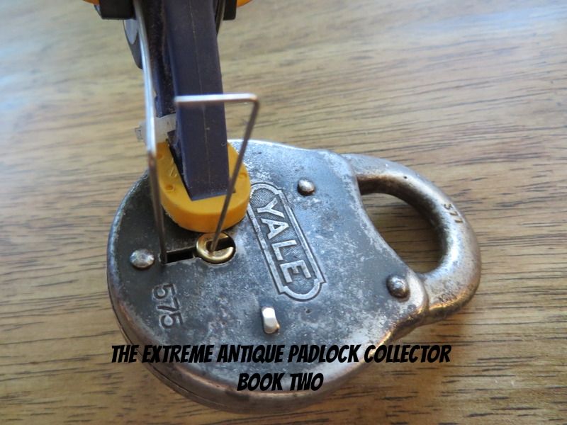

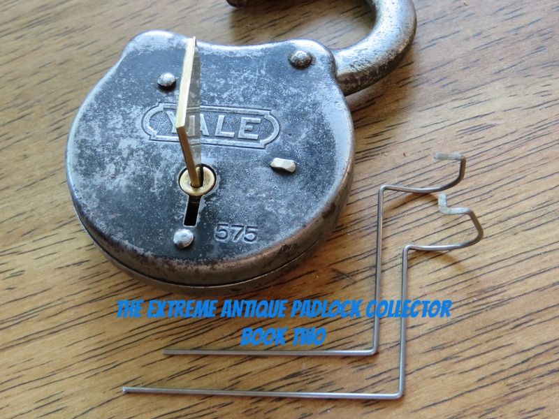

I attempted to pick this YALE (model 575) padlock open, and was unsuccessful after many attempts. As a testimony, I have been attributed to the invention of many tumbler-trapping tools (TTT) on similar lever padlocks, such as the MILLER/YALE "NEW CHAMPION", YALE 1625, EAGLE "SIX LEVER", and the list goes on. In the spirit of TTT's, I was successful in decoding my YALE 575 with the aid of clamps. The clamps provide a hands-free approach for holding and torquing the TTT, while gap-gauging the lever tumblers within the key way at the twelve o'clock position. I can trap individual lever tumblers (L1 through L3) with one particular tool, or trap three lever tumblers at a time with a secondary tool. I like the three lever tool best, because of the improved exposure given to the tumbler surfaces within the key way. Besides, this tool becomes a necessity for trapping lever tumblers, L4 through L6 as a result of internal obstruction within the padlock. Trapping tumblers begins by picking one or more tumblers, while torquing the TTT counterclockwise. A distinct displacement of the tool is felt when the tumbler gates become aligned. Additional tumblers are trapped by torquing the TTT, while applying a slight downward force to engage the next tumbler gate as the targeted tumbler is elevated using a pick. Naturally, the top most tumbler should release. The multi-tumbler-trapping tools measures .150 inch wide at the tip to retain three .050 inch thick tumblers. I like using brass stock to make a temporary key before making the finished key from steel stock (not shown). The brass stock marks tumbler positions well with less damage to tumbler surfaces, and black marker should be applied.
Disclaimer: This lock is not discussed in THE EXTREME ANTIQUE PADLOCK COLLECTOR BOOK TWO.

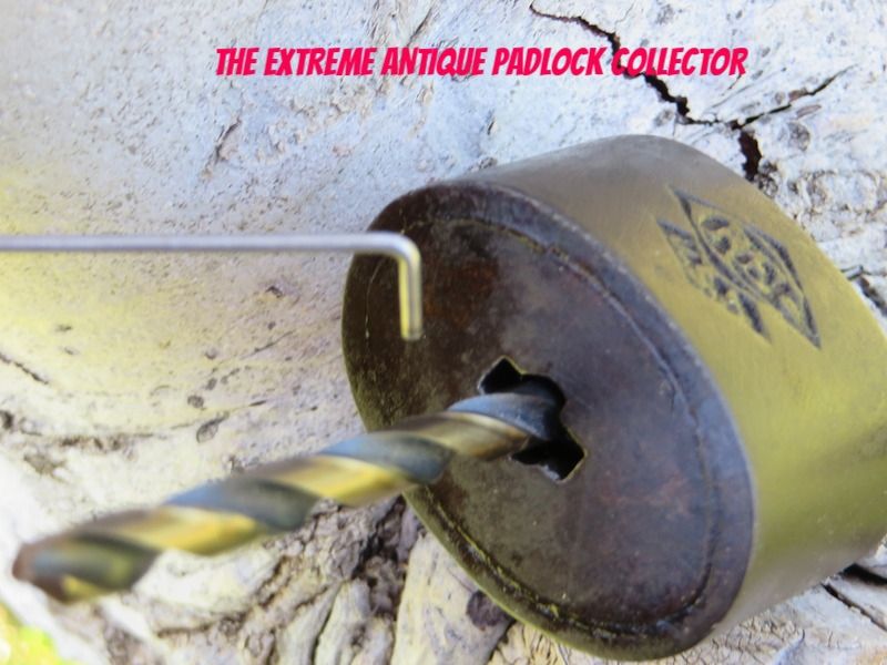

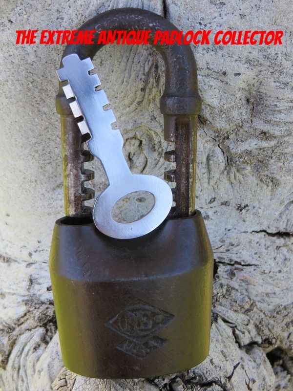

Scandinavian style padlocks are really fun to work with. I received this RUSSELL & ERWIN CO. padlock without a key and in the locked position. I intermittently inserted a drill bit to keep the discs centered within the key way, and manipulated each disc with a wire tool (starting at the bottom). Each disc tends to float excessively, and without the drill bit, picking the lock open would have been difficult. I made a key blank from tool steel and noticed that the bottom disc lagged as the key was rotated within the lock. To compensate for the lag, corresponding bits for discs one, two and three were beveled. Aside from the ward plate positions, which can be difficult to mark on the key blank with a black marker, the bit changes rests on a binary technique (either beveled on non-beveled bits).

Scandinavian type padlocks can be really expensive, especially those with keys. Yet, those without keys can sometimes be purchased at great prices. Last week, I made a working key for this newest lock in my collection. The lock was obtained without a key and in locked position. The key was made from tool steel and the lock works flawlessly. Learn how to decode these locks your self in my latest book: http://www.blurb.com/b/7793878-the-extr ... r-book-two
