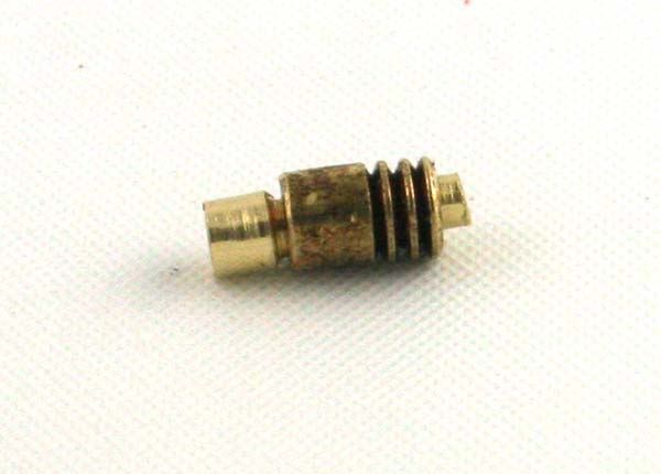

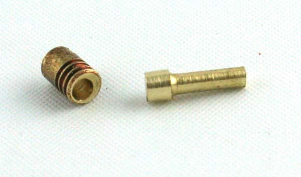

Ok, here is my idea on a telescoping pin. The proto is very crude since I done it by hand with a dremel but you get the idea.
The two pieces:
Assembled:
Concept:
The idea behind this that the serrated outer shell will be placed on top of the bottom pins with the inner pin interfacing with the spring on top of the serrated pin. With correct timing of bumping, the outer serrated sleeve will simply bounce up quickly and deflect off of the spring loaded inner pin top. The inner pin will have a slowed response compared to the non sprung outer serrated pin. The serrated outer pin will also have an impact on improper technique as if one tensions the lock improperly, the outer serrated sleeve will be locked in place by the plug.
Hope that description makes some sense. I am going to do some testing of this pin this afternoon.

Postby zeke79 » 4 Sep 2006 16:27
Results so far are that I have not bumped this lock after 150 attempts with this pin installed. I still have a few more tests in mind that I am going to do with this pin but so far things look pretty good.
On a sidenote, the pin does not act exactly as I had imagined in my concept. As the pin is inside the lock I can only take an educated guess as to what is happening but if I can confirm what I now think is going on, I really like it.

Postby zeke79 » 4 Sep 2006 18:02
zeke79 wrote:Ok, here is my idea on a telescoping pin. The proto is very crude since I done it by hand with a dremel but you get the idea.
The two pieces:
Assembled:
Concept:
First problem with this design has been found......... Construction key holes :lol: .
