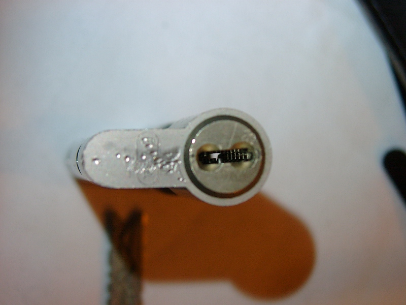

EVVA
Postby martinger » 22 May 2004 23:59
Hi,
Chucklz wrote:Uh oh....
Evva said picking is impossible
I wonder how long that claim will stand.
I don't know about the magnetic lock which really looks like a funny idea, but EVVA also makes other nice locks. We have a 3KS in the club:
EVVA 3KS Page
Image of our EVVA Key
From the top
and this one actually was picked 4 times so far, all four time by the same guy though :)
Until that happend we also considered it to be virtually unpickable und just used it to shock people asking us for our easiest lock to begin with...
Oh and don't ask me details about the damages on the front, that wasn't us. IIRC it was the original locks owner trying to unjam it after it had locked him out by mechanical disfunction, which also became the reason why he didn't want it anymore - which gives another point to consider when constructing high security locks: how much easier can they fail due to dirt or anything else?
