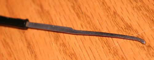

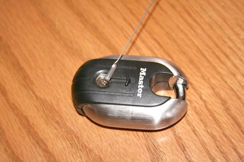

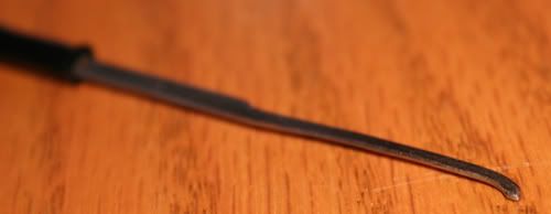

Yes, Dark Angel has it bang on I think. This lock has often been a problem for many of the guys at my LSI meetings until I put the right tool in their hand. I have a pick I made out of sweeper bristle that is a very low profile hook. Hardly a hook at all compared to a SouthOrd small hook. But using this hook, each of my friends has been able to pick this lock.
There is one spool in position 2 if I recall.

I use a semi-standard twist flex tension wrench tensioned from the bottom of the keyway as usual. Semi-standard because I made it from wiper blade inserts and it's a little narrower than a SouthOrd.
Pictures will follow a little later tonight.

Postby digital_blue » 12 Dec 2005 2:31

Postby digital_blue » 13 Dec 2005 2:42
Pick will be in the mail tomorrow wraith. You'll find these are no problem at all with the right tool.
