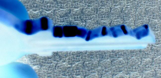

The biaxial lock has modified bottom pins - usualy on a lock the bottoms are pointed, still with me? Well on the Biaxial they are tapered like blades, or chisels should you prefer to call them. When the correct key is inserted it does indeed lift all the pins to the right height, but it also turns the pins at the same time. The key is cut so that rather than every cut being straight, as is usual, the Medeco cuts can be cut at three different angles. When the pins settle into the key cuts they turn, and the amount of turn is vital. When they all turn the right amount the holes which have been cut into the side of the pins themselves will all point towards the side of the lock, and at this point the side-bar, which has 'teeth' sticking out of it which sink into the pins allowing the side-bar to retract and the lock open. Obviously you woiuld think it easy to tell where the holes are, so Medeco cut some 'false notches' into other sides of the pins to confuse you when you are picking - what you have to do is figure out which cuts are the true ones and which are false. Perhaps this will clear it up slightly.
Look at the cuts on this Medeco key:
Hope this helps. :)
